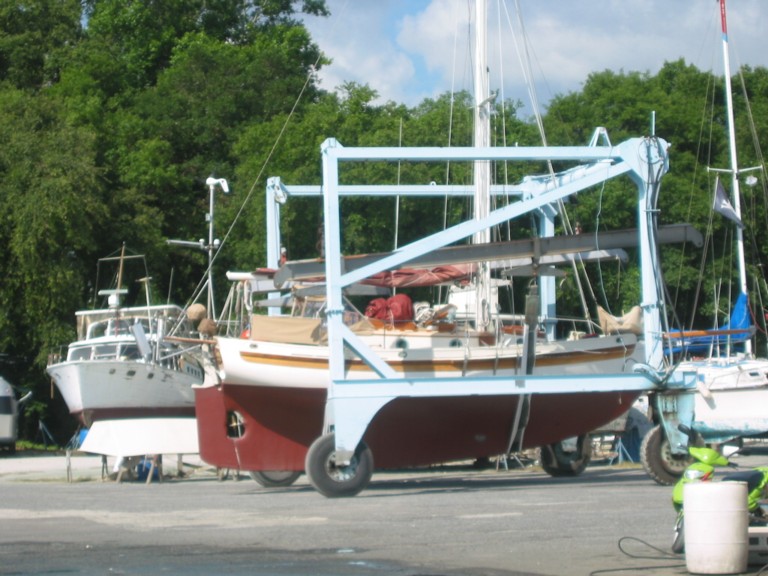

Tom, No real problems associated with the 5200 bedding. Loosened all the hardware and then drifted the bolts out of place. The rudder was solid at the mounting sites. I did this job on the hard, much easier. Good luck, Ray
Tom, No real problems with the 5200. I drifted the bolts out of place and cleaned up afterward. I did the job on the hard, much easier. The pic here is just for the fun of it. Ray
