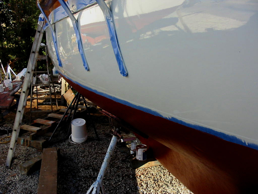

I use Brightsides on the bulwark.
After replacing the original mahogany after 18 years(storm damage)with teak in Trinidad I sealed the wood with thinned WEST epoxy and applied two sealer coats and three top coats of white Brightsides.
It was still good six years later in the states when I touched up some dings and put on one coat. That was three years ago and it could use another coat now…which it will get soon.
I was so taken with the Brightsides that in '04 we painted the hull itself using roll and tip method and it came out like a fine spray job.
