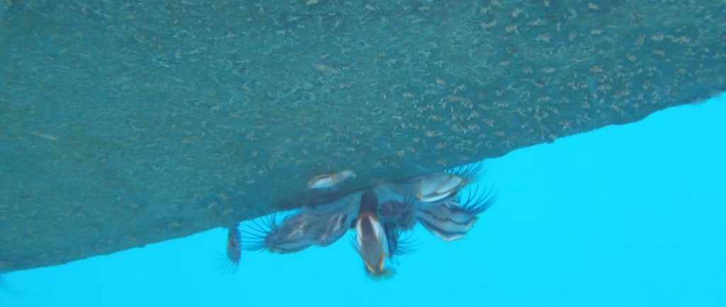

Yes , it seems every area is different . If you are talking about that copper loaded epoxy , as an antifoul , my observation and talking to owners , in Keppel Marina , Singapore , that mostly berth , their boats , not used much , experience a slime adhering first then some sort of green alge growing on that , then the barnicles start little at first then grow up . Really no improvement on ablative copper anti-foul .
Bil of BCC Zygote , he also berthed his boat, in this area of 80 degree sea water , has tried many ways to retard bio growth . For our props we both tried applying a layer of Beechems Water Proof grease to our props , my results doing this was disappointing . I wasn’t using my boat much , but in time I discovered a lime scale adhering over the beechams grease . In the end , scraping off the scale was easier with that grease applied , than without the grease ,but it still occurred .
I also tried the local remedy of putting a black plastic garbage over the prop and spurs , even after the application of Beechems Grease , but the same lime scale on the prop persisted , Ouch !!!
I think Bil and I do not use the additive of TEL or tetro ethyl lead ( ??? ) , added to our anti foul paints , because we both do our own diving to clean our boat bottoms , and are v aware of that additive’s disasterious effects in our marine, environment.
Ok , so I may have some of the terms wrong , this is our experience !
