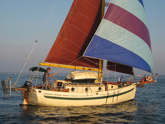

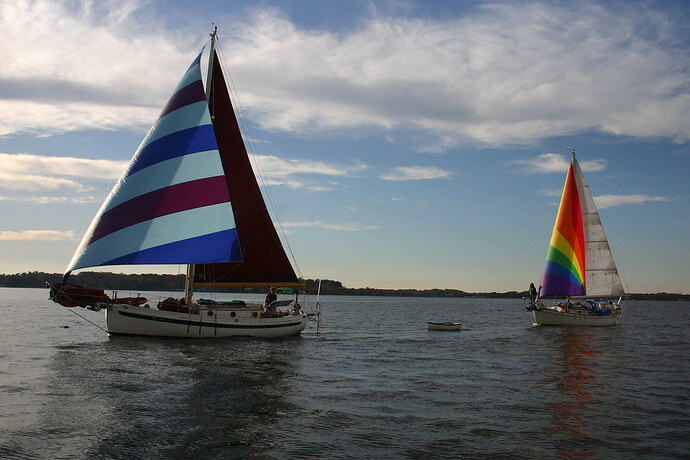

I have a drifter which I hank on. I sheet it back thru the aft most hawsepipe. Of course with it hanked on I can point to weather a bit. There’s a couple of nice shots of it here:
I also find it a bear to tack. I removed the inner stay to help reduce sheet length… But i found it VERY useful on the trip south this pat fall. I never tried it free flying. But for now, I don’t mind climbing around on the sprit like a monkey trying to rassle down a jumbo.
