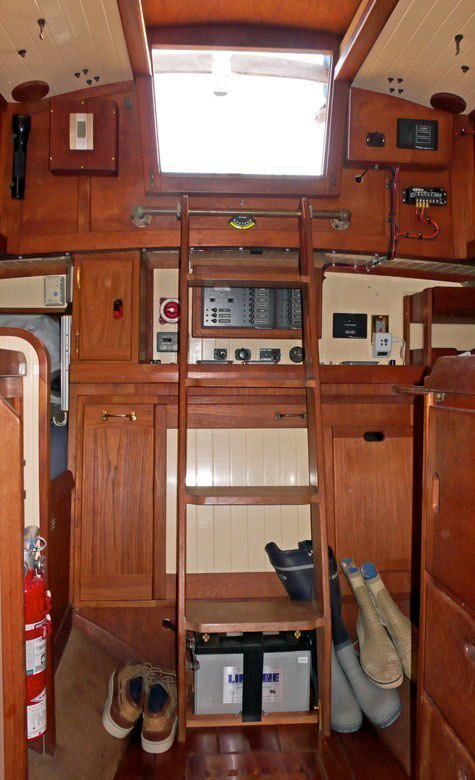

If you look up Battery Placement in Search, you’ll see several threads on this topic, including one in 2008 where I put in my 2 cents worth. We still like our under-the-ladder battery box.
Aha yes ! - I forgot to mention the engine start battery under the ladder ! The house batteries are under the quarter-berth.

If any of our owners are using golf cart wet cell batts in the under quarter berth area , that vent to the cabin opposite the stove , be aware that batt charging produces hydrogen (corrosion and explosive ) gas , in our cabins .
Just why is this gas not vented over board , I don’t know , but when ever it is possible , I will change back to gel cell or AGM batts to prevent a future melt down on my boat .
I especially like what Dan , of BCC svshaula , has done with his under ladder batt box and his choice of AGM batts , for that location .

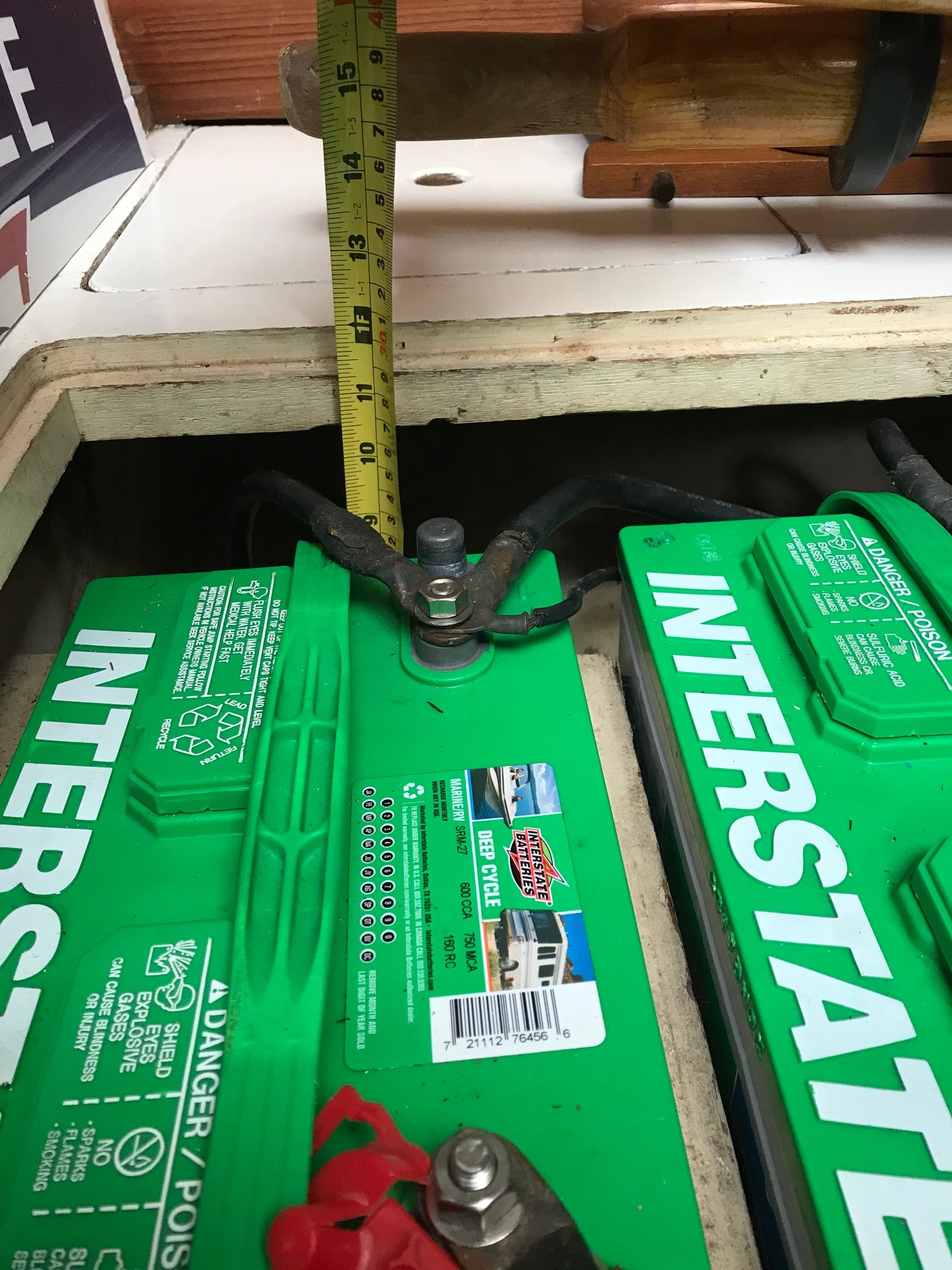

I was hoping to upgrade our Group 27 house batteries to some golf cart batteries (either T105 or J150)
Unfortunately, it appears that the starboard Quarterberth is just a touch too shallow with the current tray installed. Has anyone managed to fit these batteries in the Quarterberth?
A search of the forum pulled a few different threads on battery location but all were more than a few years old. Although it seems some have installed large banks in the lazarette, we’re hesitant to put a lot of weight back there. Plus, our energy needs are pretty modest and I’m confident we’d be in good shape with just a couple of golf cart batteries.

Thanks all for the thoughts, as always.
I like the idea of a battery box low, as in Vixen, but we have our aft water tank there.
I also like the idea of at least some batteries forward of the engine compartment, under the ladder. I need to do some measuring, but currently have two thoughts:
  1. If we move the start battery under the ladder, then we may be able to fit the golf cart batteries under the quarterberth by shifting them so the long axis is longitudinal rather than athwartships.
  2. Raise the height of the quarterberth by about 1-2 inches to accommodate the golf cart batteries in the same configuration as they are currently.

I couldn’t agree more- I think AGM (and other battery chemistries) definitely pack more useable power in the same footprint. We’ll definitely be looking into other alternatives once we begin full time cruising in a few years.
Right now we’re still weekend cruising on the Chesapeake as we slowly refit the boat. Our longest trip has been one week anchorage hopping and our current needs are minimal (no refrigeration, a chart plotter we almost never use, etc.).
Additionally, we’ve had the boat for just over 2 years and I have no idea how old the batteries are (no one punched out the date tabs on the labels). The dimensions on the quarterberth are SO close, I thought for sure someone had gotten some golf cart batteries in there, which right now would be a very cost effective way for us to meet our current electrical needs.
