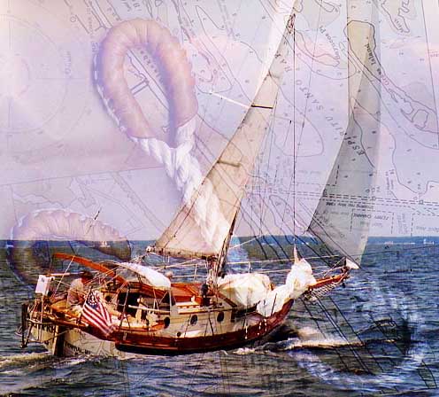

I believe the photo was taken when Bernie and Kat helped Drew deliver BCC Surprise to Maine after Drew purchased her. Attached is another picture of Surprise.
Rod yeah - I dunno drew and Rogue, is he on here? Your pic is great. Do you have a hi rez version of that?
Yes, I have a higher res scan.

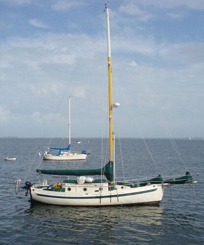

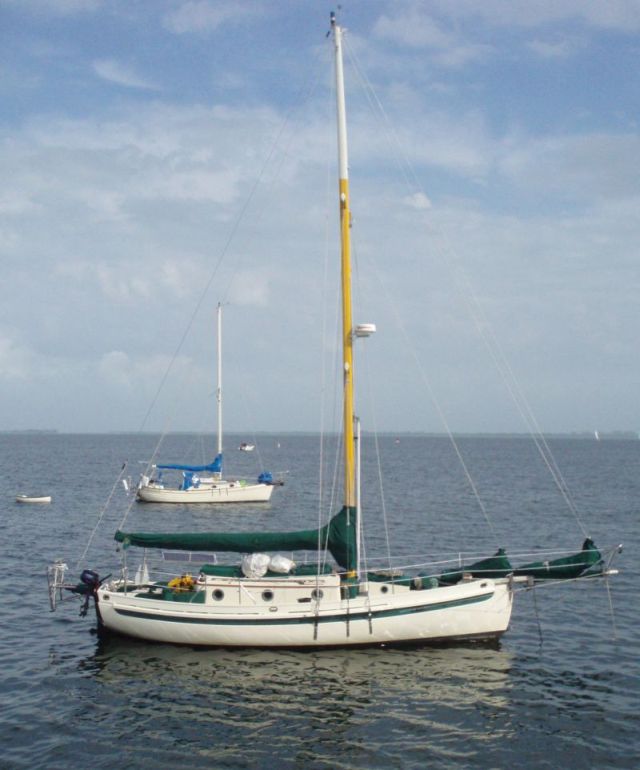

Not sure if this will make the cover of Lats and Atts, but;
gtod - good one! :slight_smile:

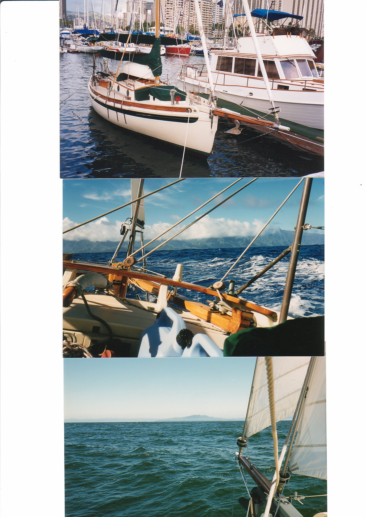

Ben , it was the scuttle hatch canvas cover, that came with the boat, that caught the upshooting green water, held it , then that water pushed through under the fwd scuttle coaming seal.
You can see in the top photo, that the cover just covered the wooden hatch and down to the hinges.
I think I already sent you a photo of my newer canvas cover, that goes down almost to the deck, and completely covers the drop board, and with this cover, I haven’t had anymore leaks.
