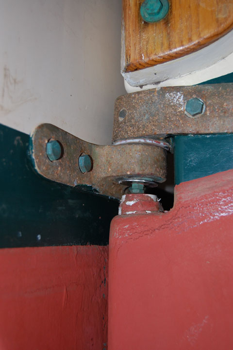

  1. Ah yes, foam core rudders. This is a subject which warrants close attention – check the 2005 archives for “rudder troubles” and you will see why. If you have one of the older style Foss foam-core floating rudders it is essential that you fit a fail-safe block which will keep the rudder from floating off the gudgeons if the safety bolts break or back off. This happened to us on the mooring the night after bringing her down from New York and it would have been nasty indeed if it had happened a couple of days earlier off the Jersey coast in a brisk and rainy November northeaster. The newer ones have less foam and a heavier glass layup and are less buoyant – but I would nevertheless follow Roger Olson’s advice and fit a stop block as described in his 2005 post.

Scott, Are there pics of your rudder stops anywhere? What a crazy story, especially on your first trip with the boat.

I’ve attached an old pic, below.

Scott, thanks for pic and further info. Very helpful.
