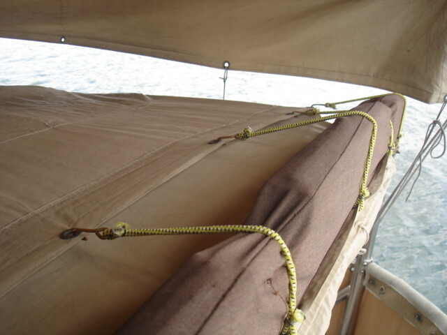

  4. Where the cover passes under that gallows there is another small flap sewn across the it. This flap is now pulled around to the back side of the gallows. To this flap I have attached 9 bungee cords with hooks on the other end.
  5. These bungee cords pass over the gallows and attach to the thwartship flap on the cockpit cover forward of the gallows. This pulls the awning up and makes it tight and smooth.

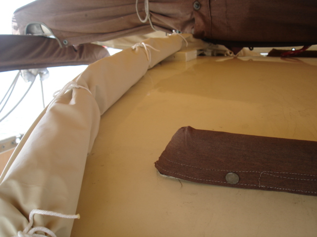

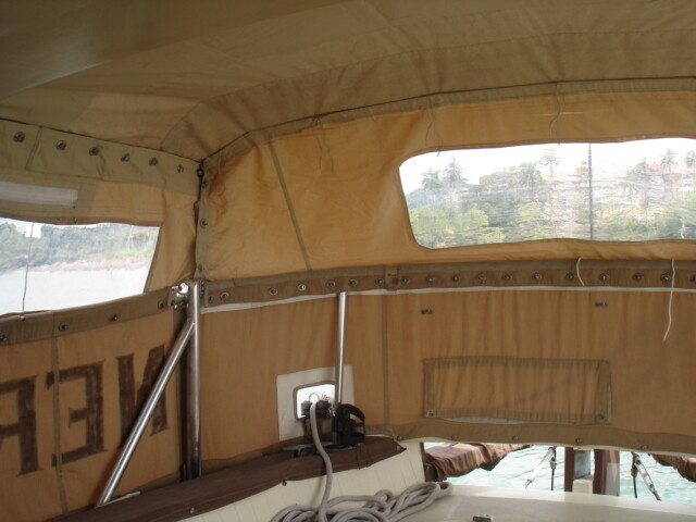

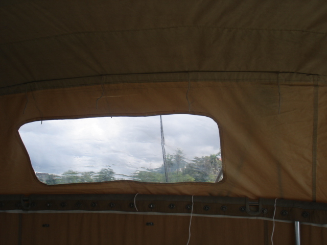

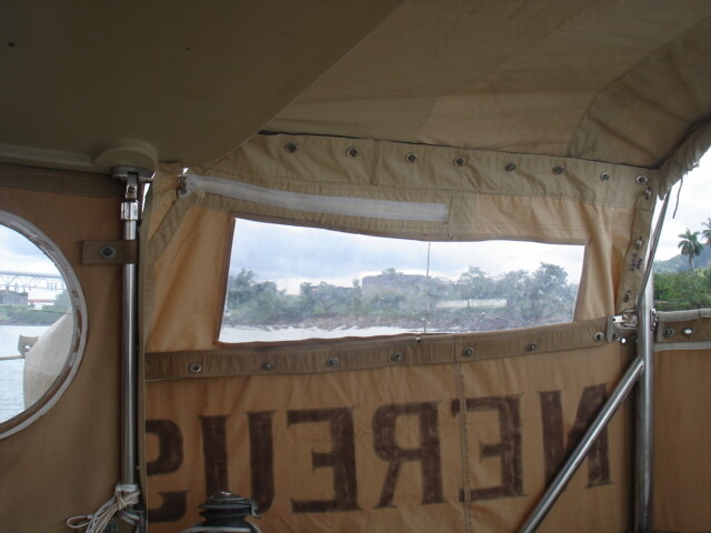

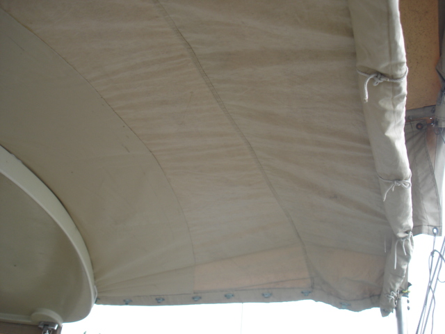

I went out to the boat today and took some pictures. 9Rod, if you are reading this, I got some shots of the dodger too. Please email me if you want me to send them to you.)
I think the photos are self explaining. Let me know if you have any further questions.
'Roger
