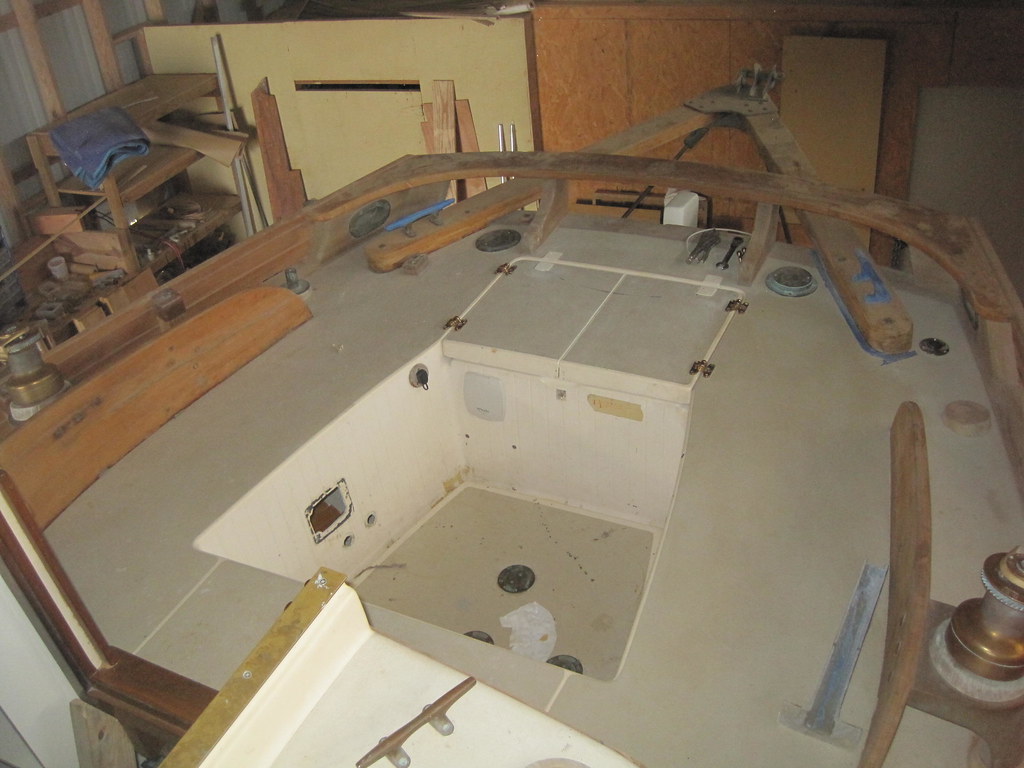

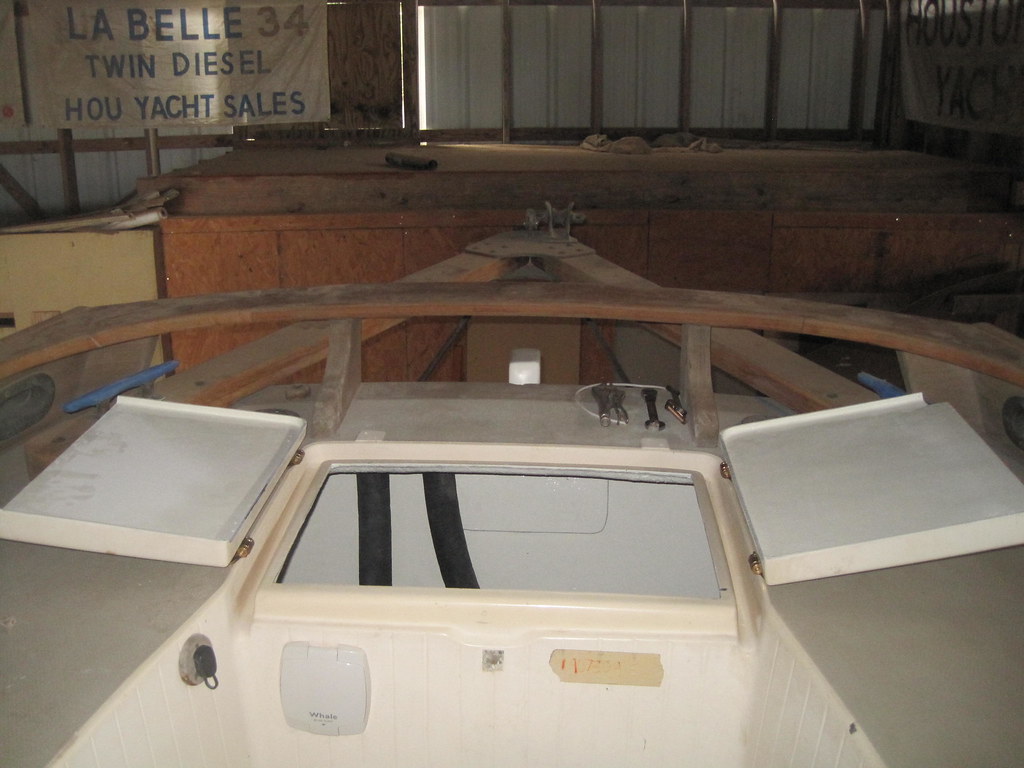

Here is a photo of a laserette hatch that opens fully while underway without hinging the tiller. Now the trick is to make it leak proof.
Here are two photos of a laserette hatch that opens fully while underway without hinging the tiller. Now the trick is to make it leak proof.
David:
Nice but how do you seal the center “seam” to make it water tight?
Rod,
There is a lip on the bottom of the stbd hatch that supports the port one evenly. The plan is to attach a 1 1/2 inch bronze strip with gasket material under to the top of the stbd hatch so it overlaps the port by 3/4 inch. I should be able to pull it down tight on the forward end with a hasp on the cockpit face but will have to devise a method to suck it down hard on the aft end. I hate to use a wing nut standing proud…maybe a small wedge that rotates into place. I have also changed out the hinges to ones a bit more freindly to the deriere. Once finished I will take a photo.

David:
Very, very nice. Could you use a car door gasket/weather strip to seal the center seam where the two hatches come together?
Rod, Excellent idea! Never would have thought of it but I think a car door gasket would compress nice and tight between the two hatches when closed together. Will give it a try and report back.
David
David:
It was just a thought. If a car door type gasket works, you may want to mount it with a little down angle to facilitate drainage. I would still install a cover plate over the seam, should a wave crash on the deck.

Douglas,
I thought about a center divider that served as both a support for each hatch and a centerline water charnnel, but unwilling to halve the opening size I bailed on that design. But the “lift out” channel could well be the way to go.
thanks,
david
