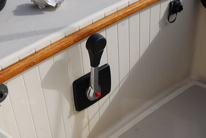

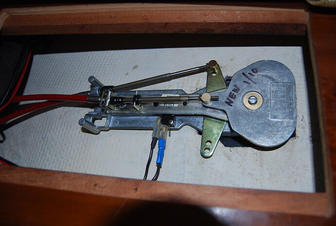

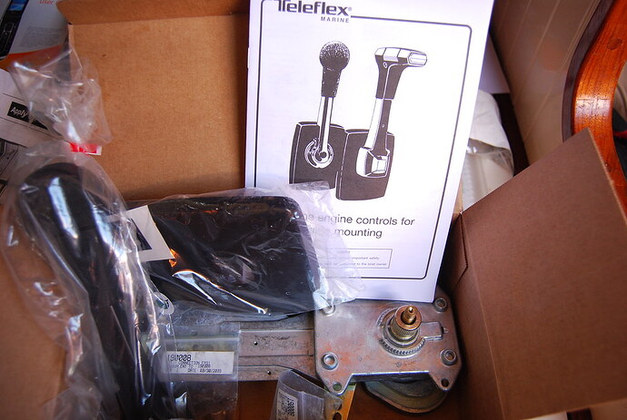

Installed new Teleflex unit, working like a champ (like all things new usually do):
