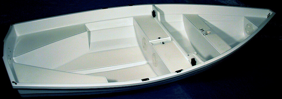

Fellow forum members: i currently stow the 8 foot montgomery dinghy which came with my BCC upon purchase in 2004 on deck, in front of the mast. Reviewing the archived comments I note at least one owner stows their 7 ft fatty knees above the house. First question: if I replace my current dinghy with a fatty knees and keep it up front on chocks do I purchase a 7ft or 8 ft dinghy?. Second question: any opinions as to wisdom of replacing the montgomery with a fatty knees?

Hi Richard, my BCC came with factory installed chocks and a 7’ Fatty Knees, that stows on top of the cabin.
Some plusses that I can think of are: It is above the level of green water that I get on deck , sometimes.
It acts like an awning over the skylight, so rain doesn’t get in.
I have rigged it as a lifeboat with the inflatable tube around the gunnel, and can keep the tube inflated when on long passages, and it is still out of the way.
One of the big minuses being stowed on the cabin top, is the reduced visability looking forward.
After hearing of the rogue wave incident of Mike Pearson, just north of San Francisco, I am still happy to keep the fore deck clear on my boat.
I like my 7’ Fatty Knees, and am not willing to change it, but if I were, I would go to an inflatable Tinker Tramp.

HI Richard, The placement of the dinghy is a personal thing and I agree with everything that Doug said above. However, I would like to add that Mike Pearson lost his dinghy forward because it was not tied down while off shore. I have sailed with a Montgomery and several other types of hard dinghies. I tried the dinghy on top of the cabin and found it was too obstructive of my view and more difficult to deploy and get aboard. If you intend to put the dinghy forward, you should have a dinghy with removable seats so it will set low as possible over the scuttle hatch. This is a problem with the Fatty Knees and the Montgomery, they both have the floatation in the seats. If you intend to use a floatation collar, this will act as your floatation. You could remove the fiberglass seats and leave just a shelf to set removable wood boards for seats. This would only be necessary for the back seat and possibly the middle, depending on the dinghy.
I would like to explain what I use and love. I have my 7’ Cherub set on the foredeck. It sets flat on the deck and is only a few inches taller than the scuttle hatch. On deck on either side of the dinghy, I have flush, through bolted eyes to lash the dinghy down when in open waters. This dinghy WILL NOT COME OFF THE FOREDECK. In order to make the dinghy set flat or as low as possible, I had to cut the end of the bowsprit off flush with the aft end of the bitts. When the weather is really bad and I have to go forward, I find there is plenty of working space on the side of the dinghy. Also the dinghy provides some protection from breaking waves. At anchor, I raise the forward end of the dinghy so I can open my scuttle hatch. The dinghy acts as a windscoop and keeps out all rain except when the wind is strong. To deploy the dinghy, I lift one side so it sets on the other. Then use a two point bridle to lift it off the deck, over the lifelines. As it goes down into the water, I have a line attached to the lower side of the dinghy that is attached to the lifeline. This line becomes taught just before the dinghy hits the water. The dinghy then sets on the water right-side-up. To raise the dinghy I use the opposite procedure. If you want more detail on how this is done, let me know.
I do not have a floatation collar on my Cherub but I do have 5-6 inch fenders lashed to each side to the dinghy. These are lashed together and have a clip on each end of the rope so they can be easily removed. Also, if you would like more information on this let me know.
Regarding the size of the dinghy. You are limited on how high you are willing to have the dinghy set. Let me mention that you can set a slightly longer dinghy on the cabin if you set it at an angle. You can set a longer dinghy on the foredeck if you are willing the have the stem set on top of the bowsprit, aft of the staysail stay.

One last comment. If your BCC has the Dorade Boxes with Cowl vents located near the center of the cabin, a dinghy will not set on top of the cabin unless you remove the vents. Most BCC’s that have the dinghy on top of the cabin, the dorade boxes are installed at the forward end of the cabin.

Ahoy Roger, T Y , for that explanation, as, it appears that I hadn’t got the full story from Mike.
Of course I didn’t know that the cherub gunnel, was contour fit to the BCC fore deck, and that is a very good design idea, as it could prevent that green water from getting underneith and lifting.
A few times, I have plowed through short vertical standing waves, and when that green water hits the front vertical surfaces of the scuttle hatch coaming, and the propane deck boxes, the water goes vertical too, then comes aft in the air, soaking me if I am not sheltering under the dodger.
I had to install a canvas storm cover over the scuttle hatch, to keep that green water from siving through the hatch seals and soaking things below, but I can see now that your Cherub acts as a hardshell storm cover too, a big plus.
Do you think that you can fit that Walker Bay dinghy flotation collar to the Cherub ?

I think the collar for the Walker Bay is too long but it can be adapted. I considered using this collar but when I saw the cost, the fenders had a lot of appeal.

Mehmet, We used an 8’ Trinka for years on our BCC. Trans-Atlantic, Med, Carib., Panama Canal and West coast of So. America. Before this, we used a Cherub, a Walker Bay, and a RIB. The Trinka was the standout of the group(we still own it) stowed on the foredeck (roller foresail, hank on staysail)with no problems. We rowed almost everywhere(try getting a quick anchor out in an inflatable with the wind up), motored when we felt like it(2hp Honda pushed it nicely, even with 4 adults and luggage, with a whole inch of freeboard to spare!), and sailed it around a lot of anchorages with sundowners in hand. You meet the nicest people this way. We used a bridle and spinnaker halyard much like Roger described and my wife could launch and retrieve on her own(always a litmus test on our boat) with a struggle.
