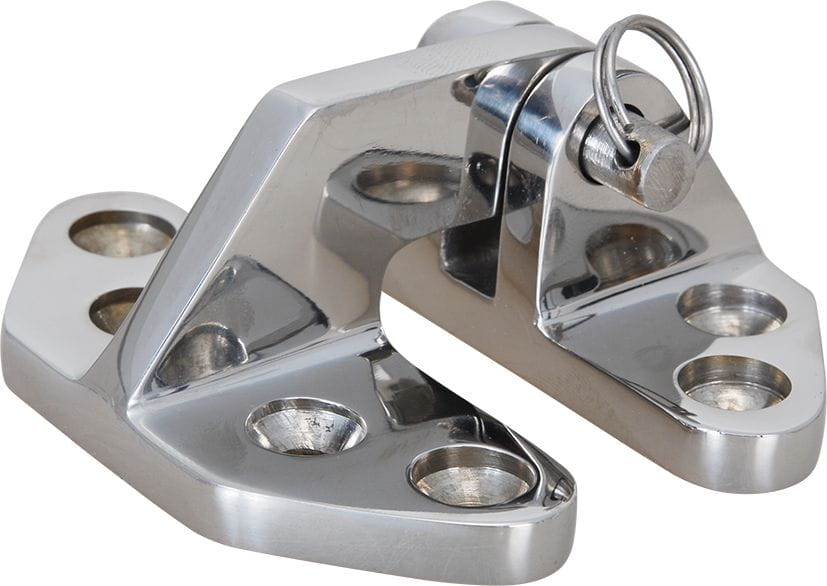

Does anyone know the proper dimensions for the foreward hatch hinges commonly used on BCCs?
I’ve seen BCCs and FCs set up where the forward hatch uses 2 or 3 hinges per side so the hatch can open forward or aft for airflow, or be removed for loading/unloading sailbags, but my BCC just has strap hinges equipped currently.
So, wondering - what is the appropriate size for these?
IE: like these:
While this post is a little dated, I just saw it and wanted to respond.
The width is approximately 3” wide, the height is approximately 3 1/2” tall and the thickness of the arm is approximately 3/8” thick. They stick out approximately 1 1/4”.strong text
Thanks, Peter. Just what I wanted to know.
I used two stainless each of the heavy duty ones shown in your email. Also on the skylight…aft side only.
