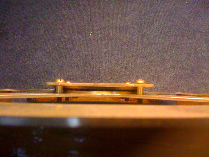

As the movie shows the evolution over the years, it continues to this day. On the underside shown in first attachment photo you will see four Delrin washers. These keep the large wheel located to the bottom plate, where the bearing balls are nestled in a race top and bottom - this creates the "lazy susan " movement.
One day while discussing various things on one of their stop overs here in Newport Beach, Larry had mentioned that he once “lost his balls” …I belly laughed with him and said I did too… meaning the “bearing balls” had escaped once on me as well. I checked with some other long range sailors and they had the same problem. Turns out that the delrin washers after five years or so wear down and by doing so creates a little slop in the set up, resulting in the balls escaping. Mike Mallory (who is finishing up a solo circumnavigation) simply turn the washers upside down and continued with no problems.
As the evolution continues Larry came up with the fix for the problem. He installed two flat metal bars to the bolts that held the delrin washers. Metal to metal, so they could not wear out, see attachments. After viewing this, and having access to a watercut machine I had Aquatek cut a ring that would connect all four bolt locations and eliminate the problem… see attachment.

Attached photos show the bearing keeper from various angles. Very simple. Works perfectly. Metal to metal but it doesn’t actually touch except occasionally when there might be some upward pressure on the top part of the vane - i.e. when someone grabs hold of the backstay of the boat. Just keeps the two parts of the bearing races from lifting apart.

So, there you have it, evolutionized again. If anyone with a Freehand wants to make the change to the new bearing retainer plate, e-mail me at Mav5252@aol.com…or simply turn the delrin washers upside down when they wear down as Mike Mallory has done.
