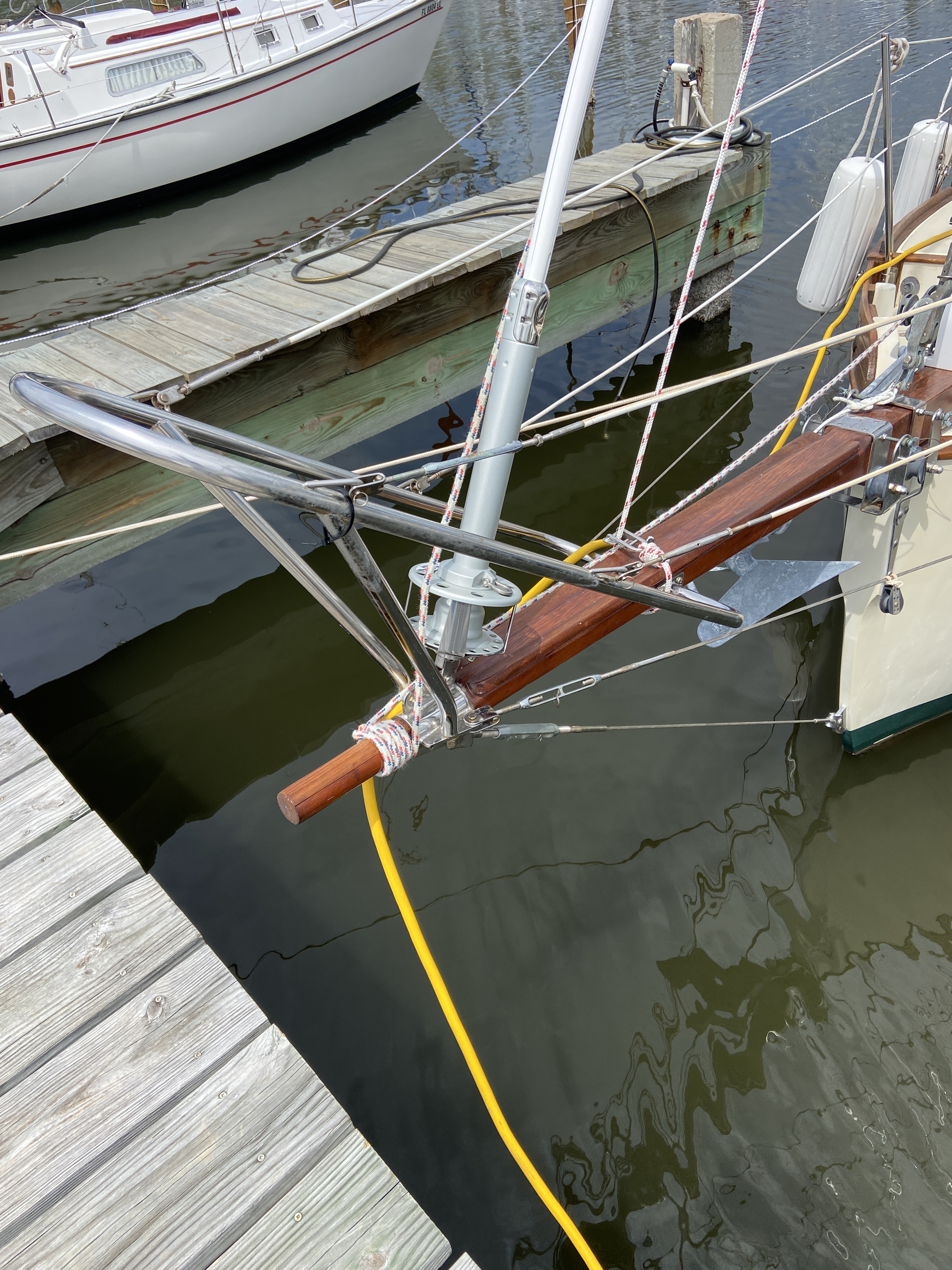

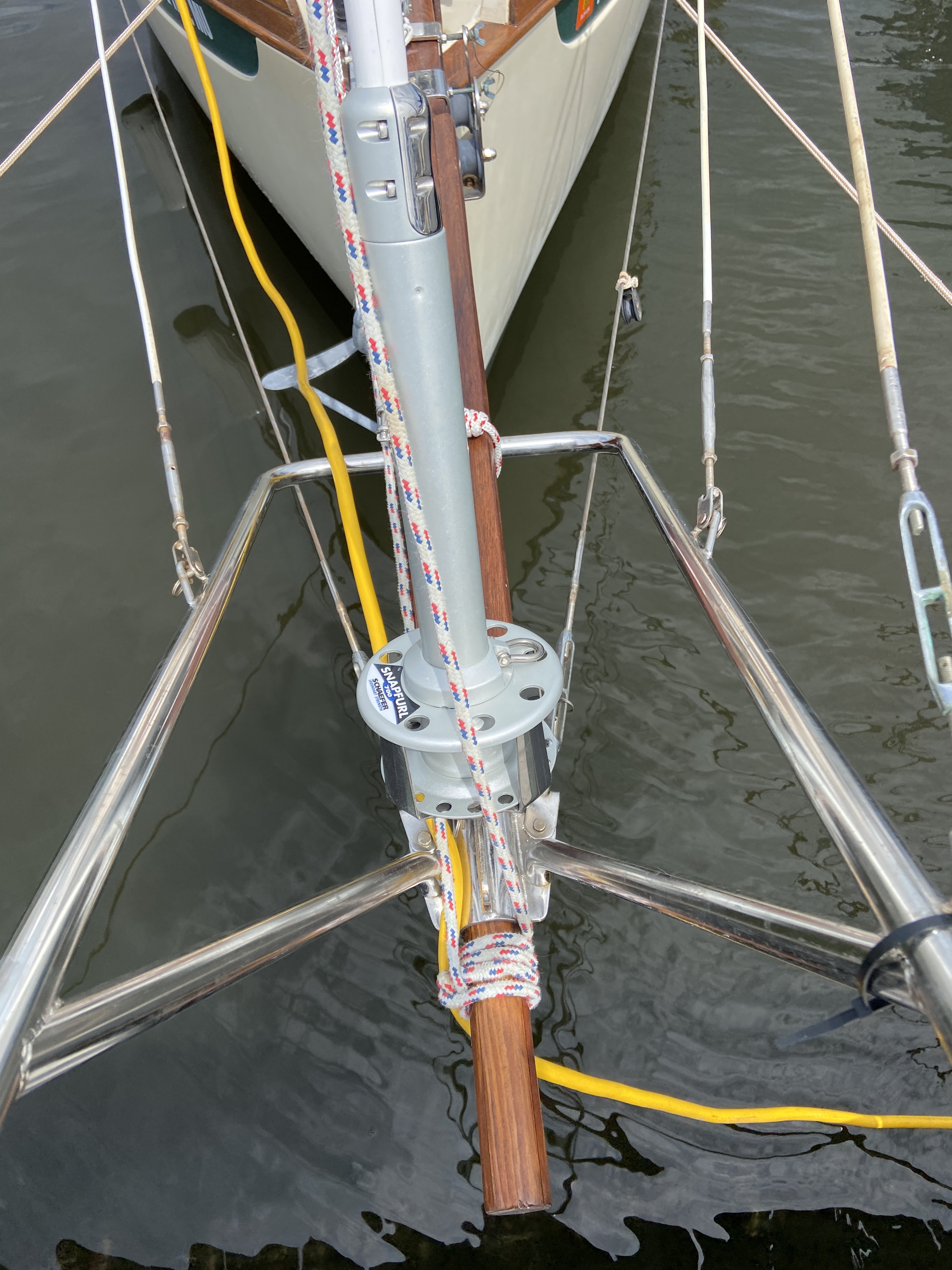

Installed the Schaefer CF-700 and I must say, it looks good and works great.
