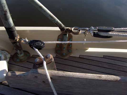

We lashed a 40 mm Harken Carbo Ti-Lit block (# 2651) to the whisker stay to lead the furler control line into the drum of the furler. I have a series of photo showing our furler control line setup. I need to resize the images before I post them at the forum. I should be able to post them sometime today.
We also lashed 40 mm Harken Carbo Ti-Lit blocks to our stanchions to lead the furler control line back to the cockpit.

Tom:
Please find attached several images of IDUNA’s furler control blocks. All blocks shown are 40 mm Harken Carbo Ti-Lit blocks. These are lashed to the stanchions and one is lashed to the whisker stay. I use two types of twine for lashing and whipping. The black colored twine is tarred nylon seining twine, whereas the brown colored twine is “tarred” marlin. Before I lash a block to the stanchion, I whip the base of the stanchion in a manner referred to as “French whipping.” The block is lashed to the stanchion per Harken’s instructions.
The ratchet block is also a Harken Carbo block. We installed this at the suggestion of AO Halsey who sails a Falmouth 26. This helps take the load off the hands when furling the sail. The Tufnol cam cleat is fitted to a silicone bronze custom bracket.

My suggestion is to mount the furler lead block to the whisker stay and test it. Position the block such that the lead into the furling drum is 90 degrees to the drum. This will help ensure, the furler line wraps evenly around the drum. If you do not like the setup, move the furler lead block to the bowsprit. Instead of drilling holes in the bowsprit, you may want to lash a round rope thimble to the sprit then attach the lead block through the thimble. We use a round thimble on the second stanchion from the bow, to lead the furler control line aboard the boat. I will take a picture of this thimble today and post it. Should you decide to use lashing on the bowsprit, I would use “tarred marlin” which is available at www.hamiltonmarine.com . You may not find it on their web-store pages, hence telephone.
