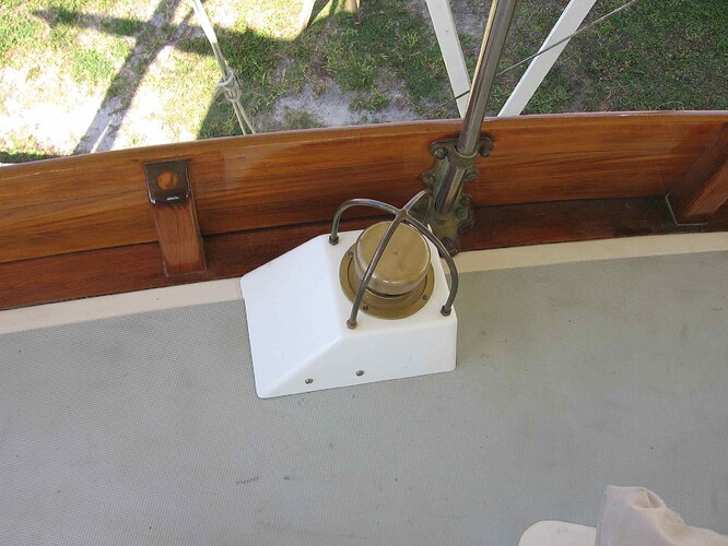

i am attaching a picture of the mushroom vent that was adapted for the air head. it is tied into the original waste fill opening which kept me from needing another hole in the deck.
