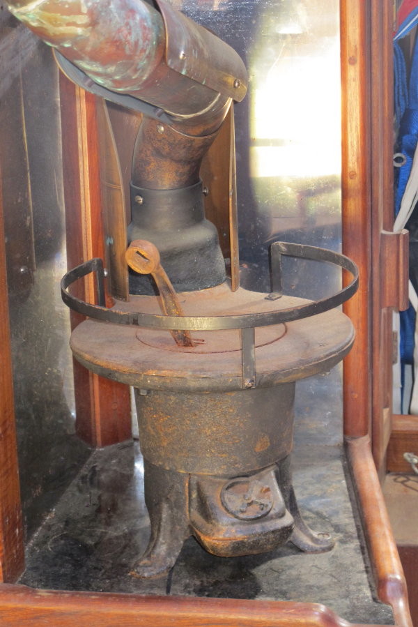

Not a diesel heater but a couple of snapshots for you, also not a FC but hopefully give you some ideas
Tim Pearia
BCC Scallywag
Not a diesel heater, and not FC but give you some ideas
Tim Pearia
BCC Scallywag
