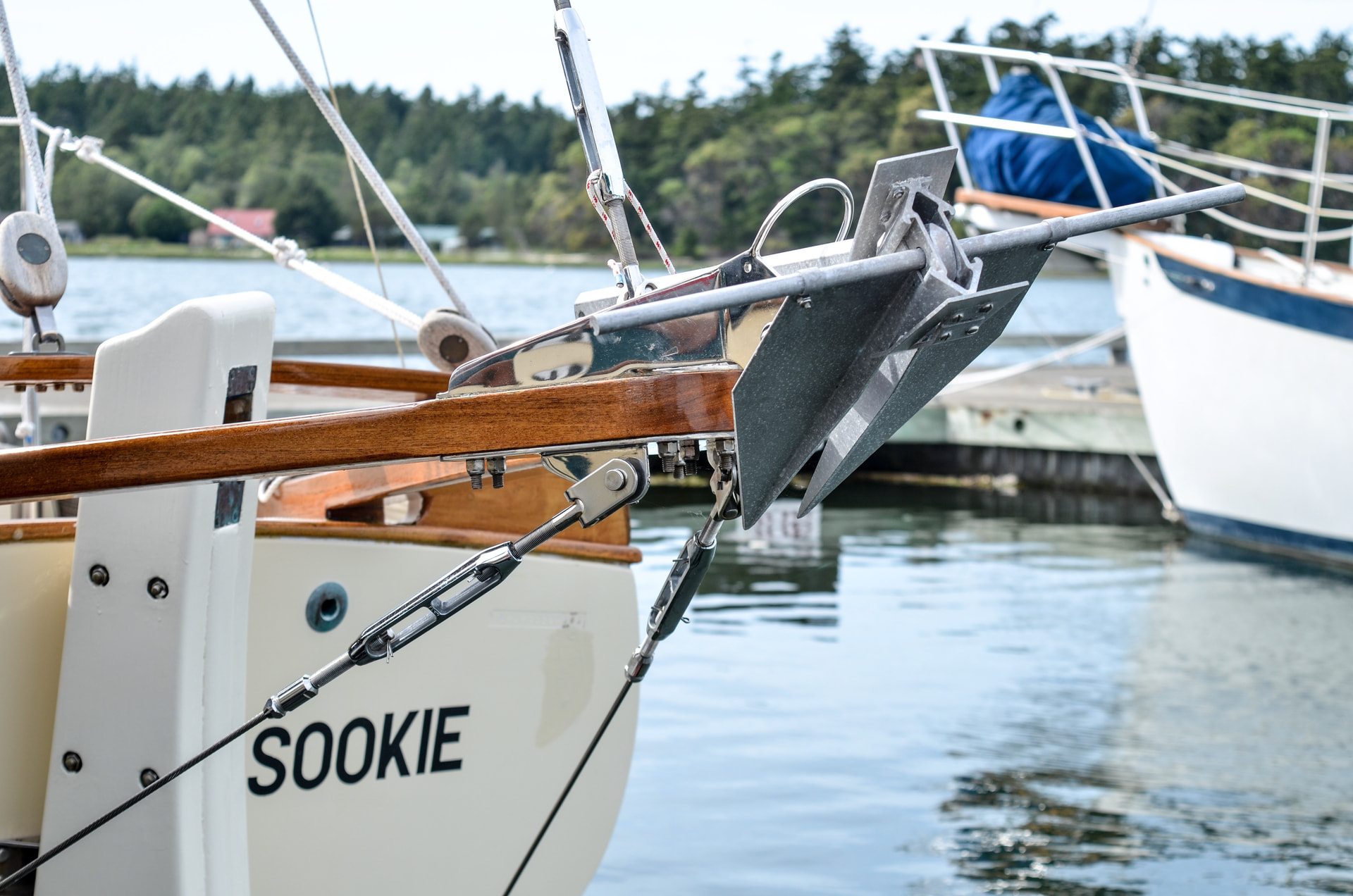

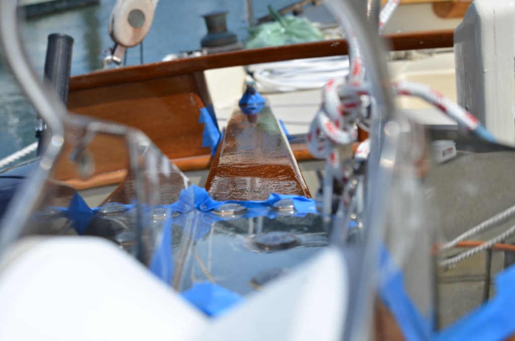

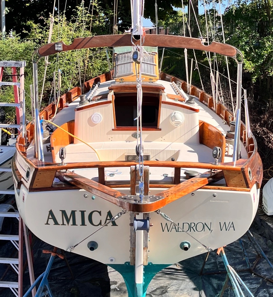

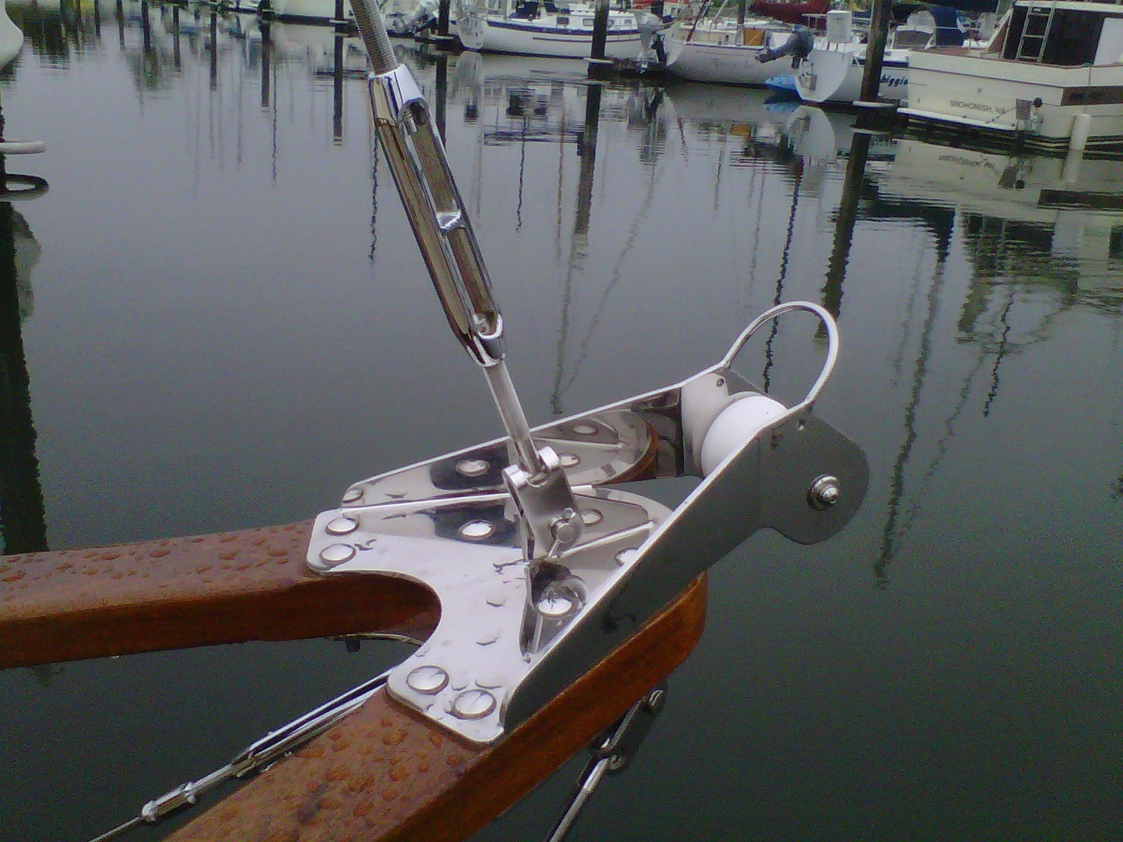

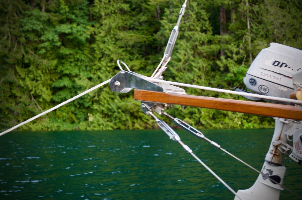

For me, the only anchor I will ever use on the stern is a Fortress with rope only. Here are a few set ups from my FC and BCC. The FC worked much better.
Here is a pick of the line lead straight from roller, across cleat to cockpit winch.
Exceptional @barefootnavigator. I see how using only rope neatly solves the rode problem!
Say you wouldn’t have a spare one of those rollers to sell? Or supplier/CAD/plans/specs :folded_hands:?
Mike Anderson would be the contact on that. If you have one made I might have a slight design change on the top roll bar. Having said that, it worked flawlessly.
