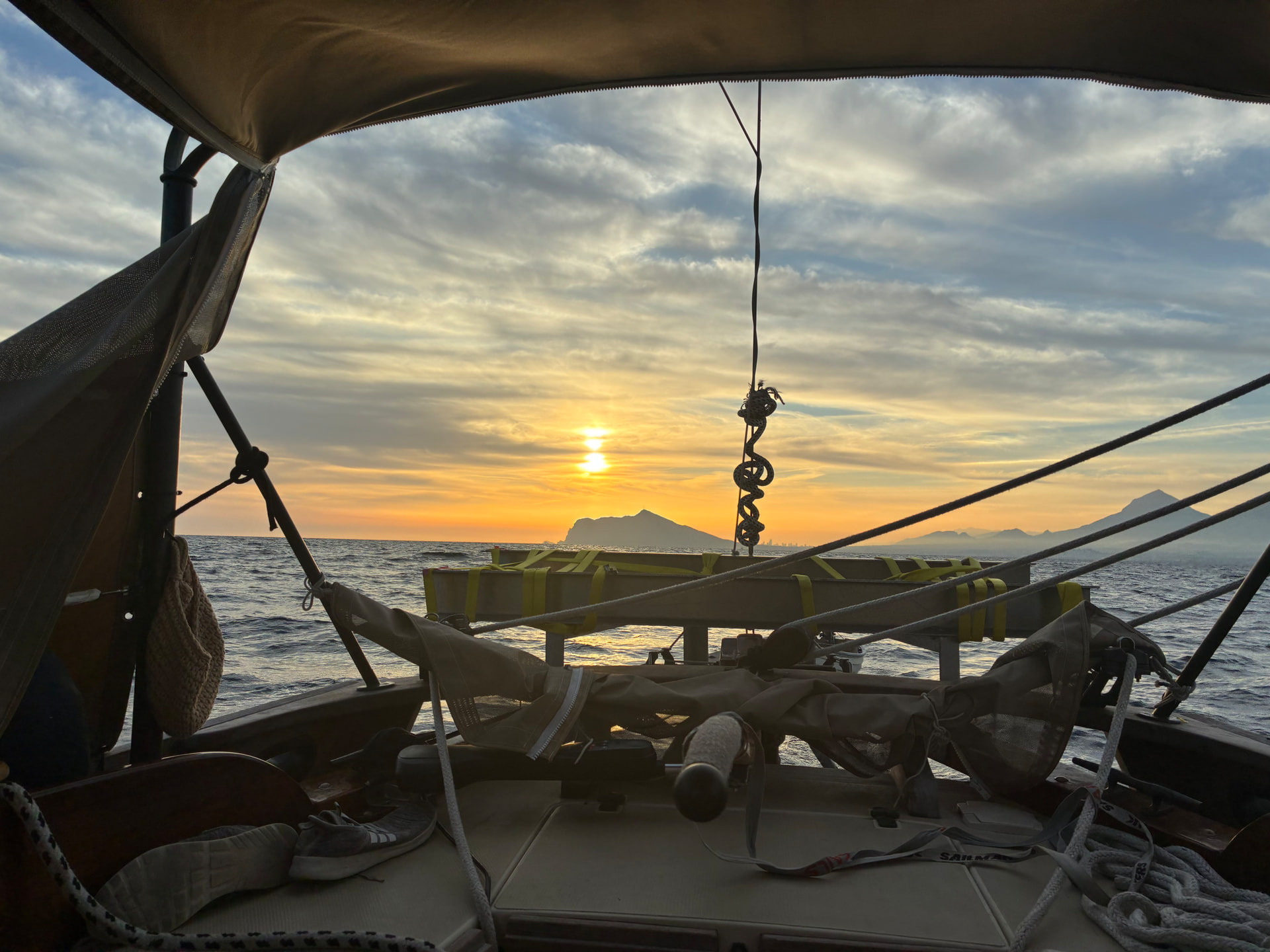

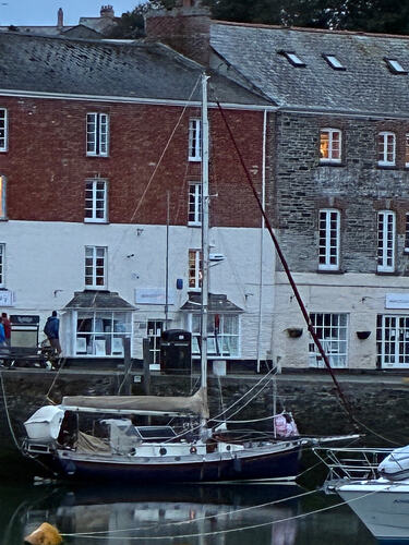

I’ve mounted my fatty knees tender on the boomkin
While in Peterhead, Scotland last summer, I wandered down to the large fishermen’s port. There I found & hired a local metalworking shop to build a solar panel mount for my boomkin.

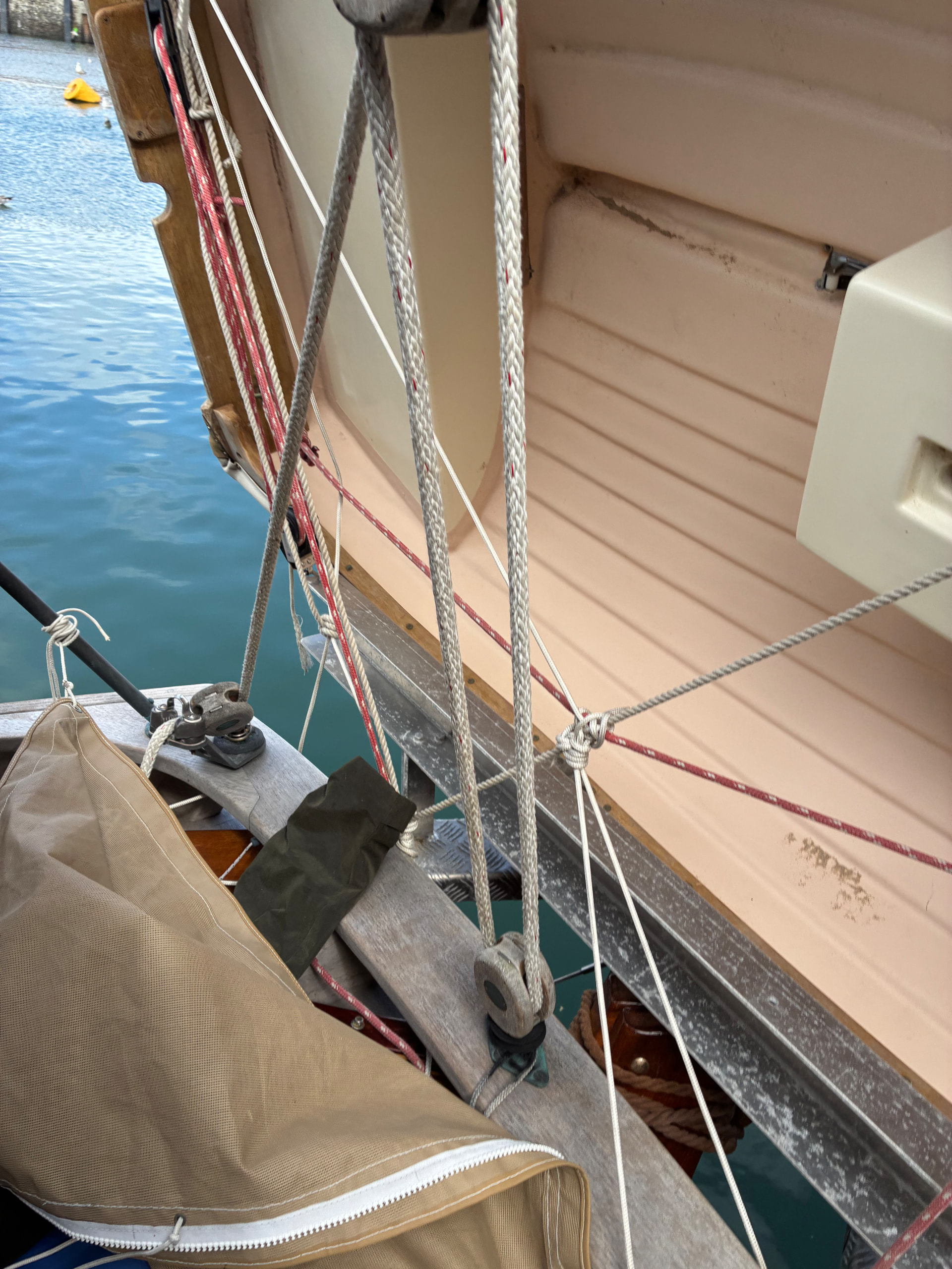

It was so overbuilt that with a single modification - adding a sort of hammock made from spare jack line straps - I repurposed the mount as a secure home for my tender. (Mounted the solar panels in the tender’s old spot, between dodger and skylight.)
Some photos:
Pros:
  • Easier to deploy and recover tender with boom.
  • Protects the cockpit from large following seas (eg was really nice when running in front of 30+ knots/12+ foot seas off Land’s End, Cornwall last autumn).

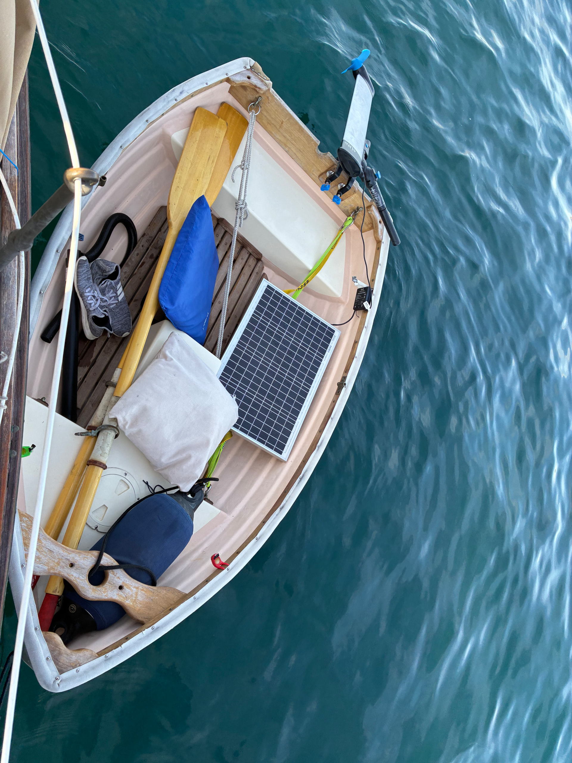

  • Easier to do inboard maintenance / upgrades (eg I mounted a small solar panel in tender for expeditionary recharges of my electric outboard).
  • I can open the skylight without moving my tender.
Cons:
  • Is sorta ugly. Maybe if I wrap the contraption w/ some old rope in a decoratively seamanlike manner it would improve…
  • Worry a bit about excess pressure on the boomkin/backstay/mast - the small fatty knees isn’t so heavy, but still - any opinions on this?
  • Solar panel sun exposure suboptimal in many circumstances due to shade from dodger, boom, and/or sails.
  • Preventing backstay chafe on dinghy’s hull a challenge.
  • When reversing in tight spots must use jedi mind powers to avoid a collision. Or steer with one’s foot (also a jedi skill).
  • Windage.
What do y’all think of this setup? Should I be concerned about damaging boomkin or rigging? Anyone else added new davits or dinghy mounting strategies? Been rolling with this setup for about 5 months.

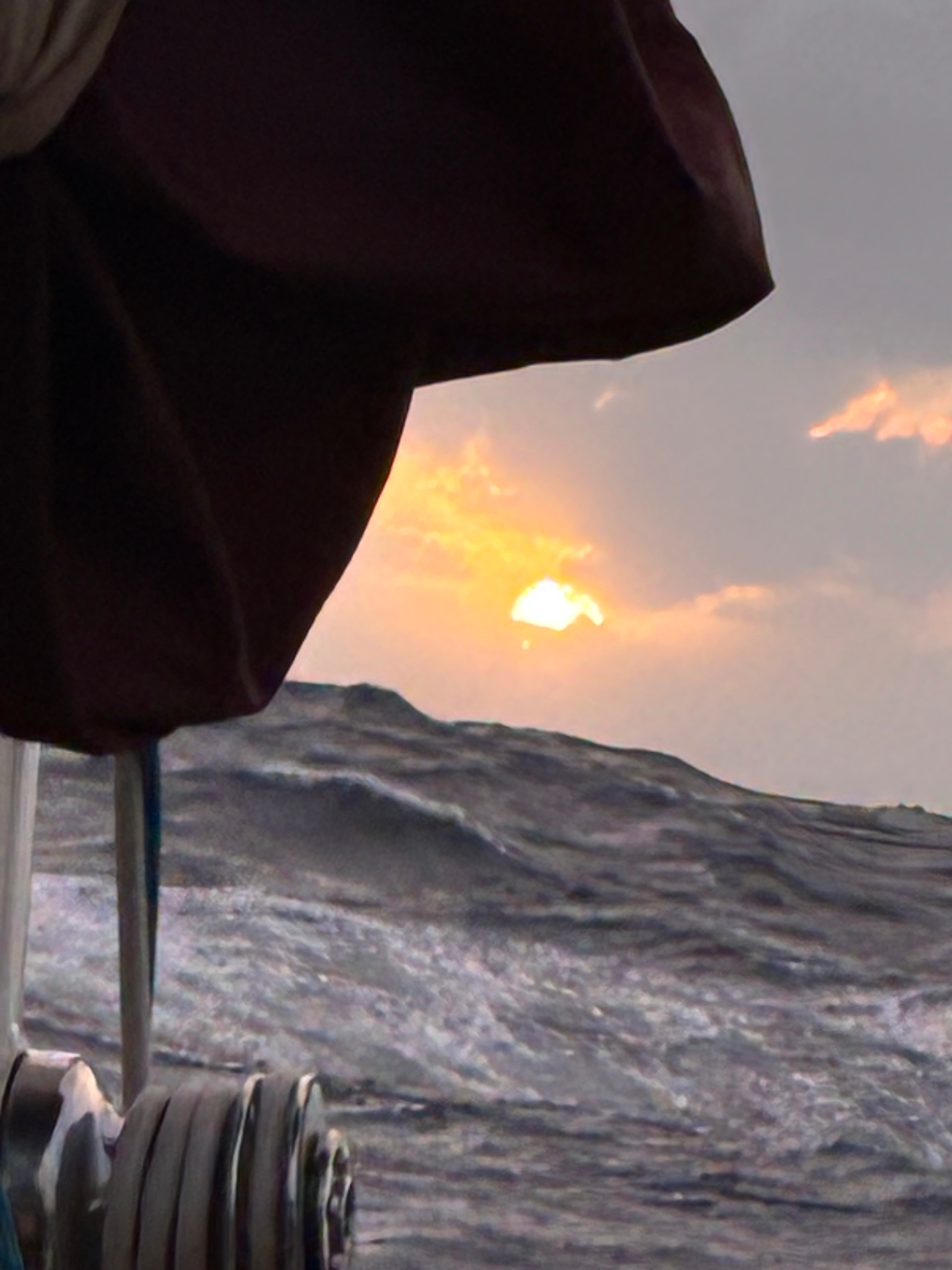

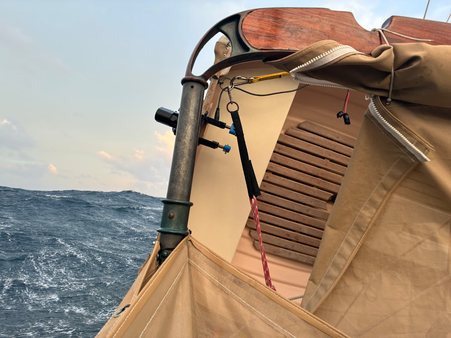

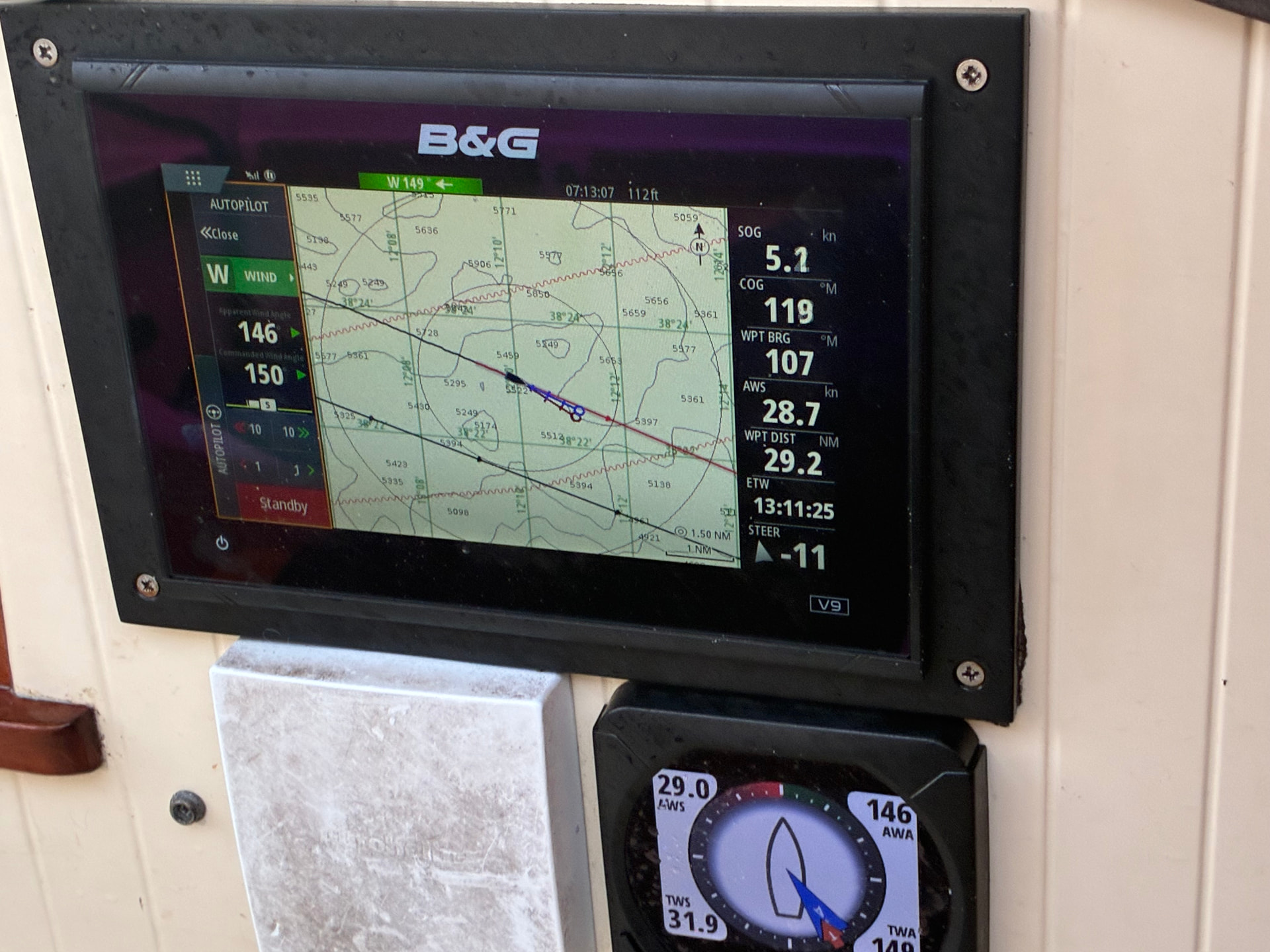

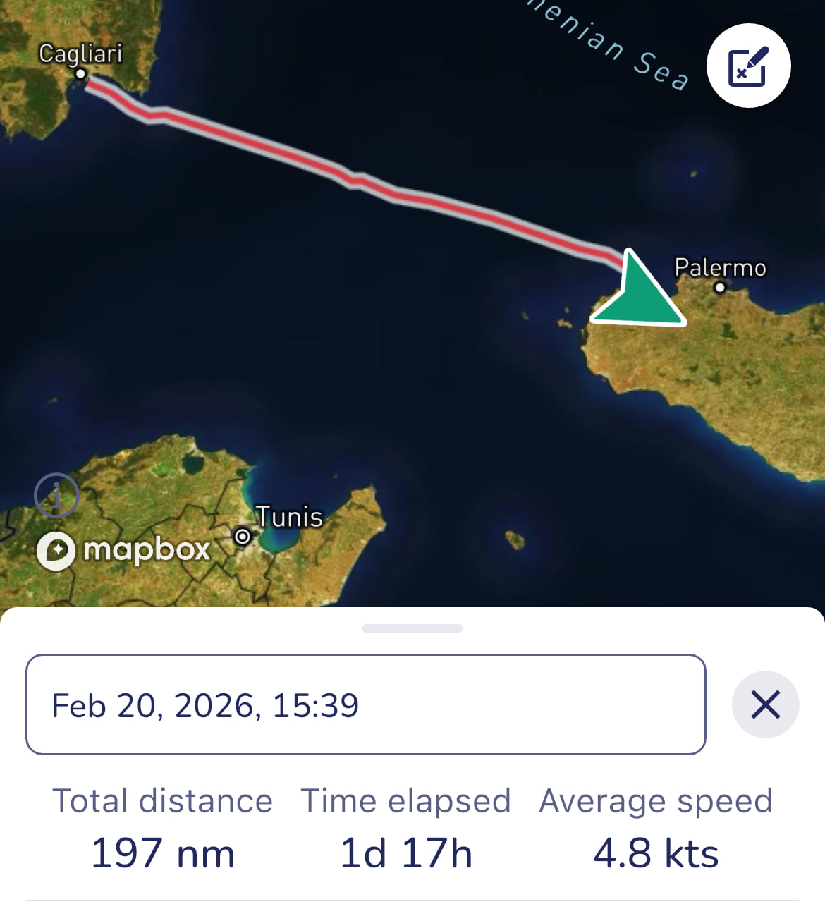

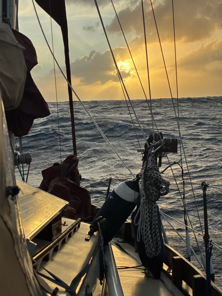

I actually just did a live trial offshore in heavy conditions :grimacing: - I arrived last night after a 36h passage Sardinia → Sicily. On the final night conditions were F7 verging 8 for several hours. I ran under bare poles or a t-shirt’s worth of genoa for nearly 12 hours!
We had six big waves break over the stern, but the dinghy provided excellent protection. Cockpit didn’t swamp once; I was dry. It wasn’t a night for trusting the autopilot - the protection was very welcome.
She/boomkin/stay didn’t show/sound signs of strain. That said if conditions had further worsened (forecast was F6 verging 7!) or strain showed I’d have had problems. Can’t reef a dinghy, and I reckon the windage would’ve been much worse if I’d sea anchored to survive. My backup plan was cast it adrift and file an insurance claim :downcast_face_with_sweat:. (Protection over the skylight would have been nice too.)
