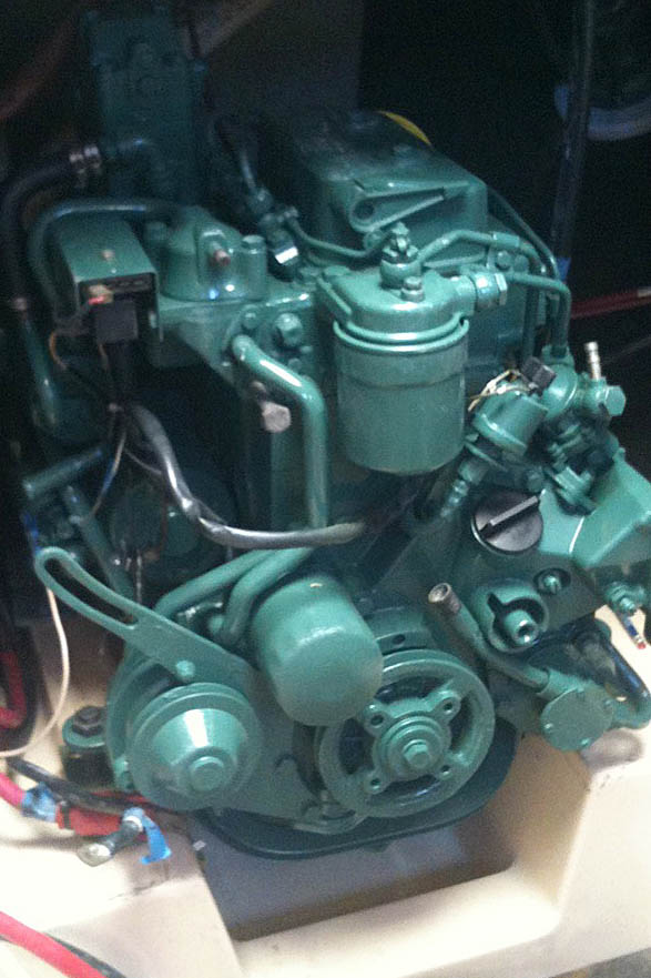

It’s sad Rick, I had just finished a complete rebuild of my drive train with the engine out of the boat. Got her all painted up nice clean and serviced. See pic. now I am wrenching on her and she won’t look as pretty now…after all my motto is:
If you can’t sail good, you should at least look good!
