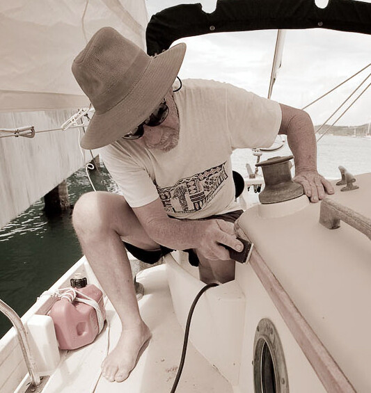

Hi Gary,
In one of your photos you seem to be holding a small electric device to strip the varnish. What kind of gadget is it?
I use heat gun. But it is very difficult and messy.
Mehmet,
It’s a standard scraper. Looks like something electrical because of the heat gun cord in the photo.
I use a heat gun too. I think it’s the lesser of two evils.
