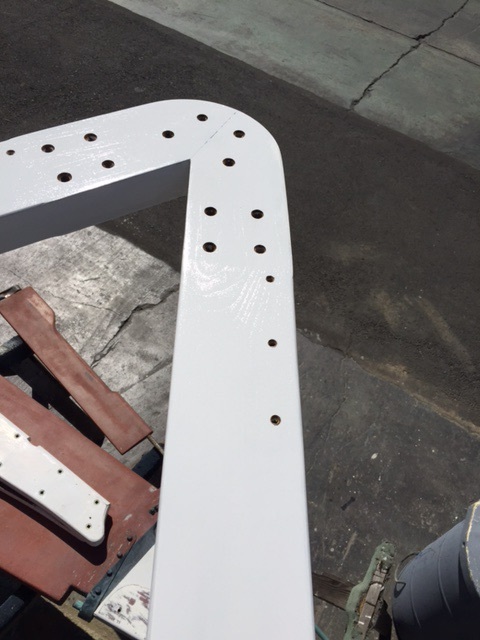

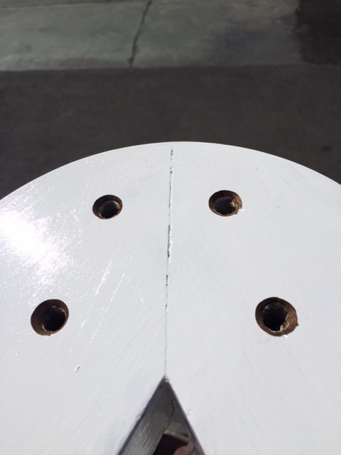

I decided to countersink everything that’s going to be bedded in butyl (see attached photo). After countersinking I applied a two part clear epoxy with a trimmed acid brush.
I decided to countersink everything that’s going to be bedded in butyl (see attached photos). After countersinking I applied a two part clear epoxy with a trimmed acid brush.
Good idea! From now on I will also countersink slightly - that must result in a superior seal!
