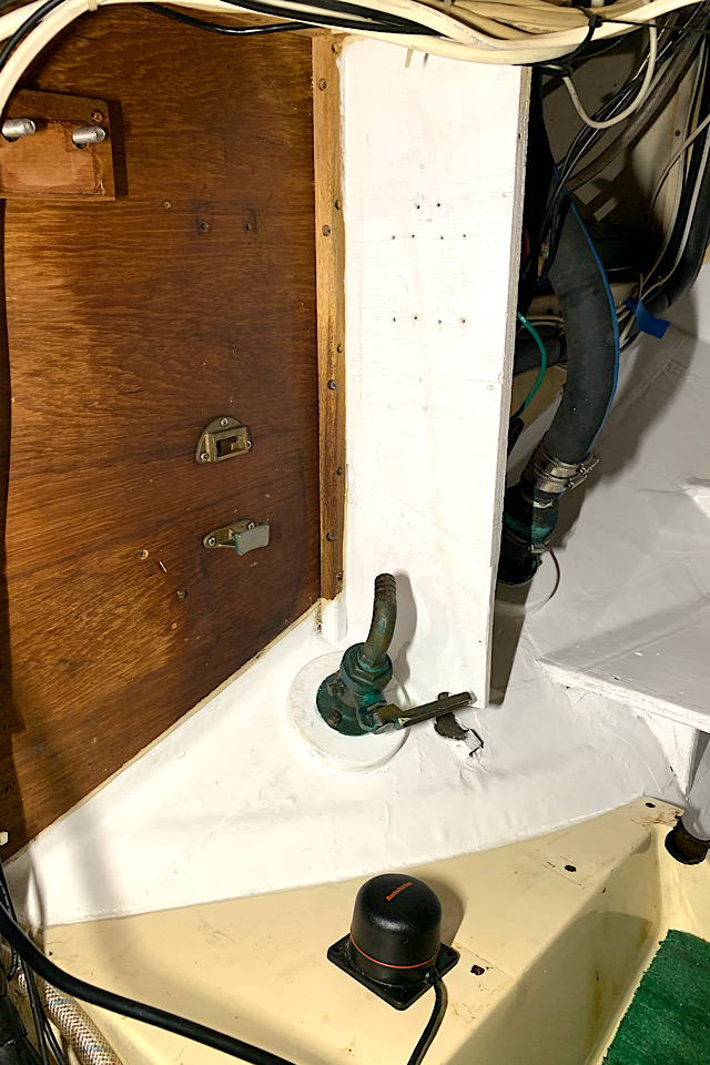

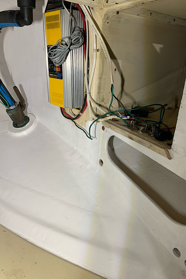

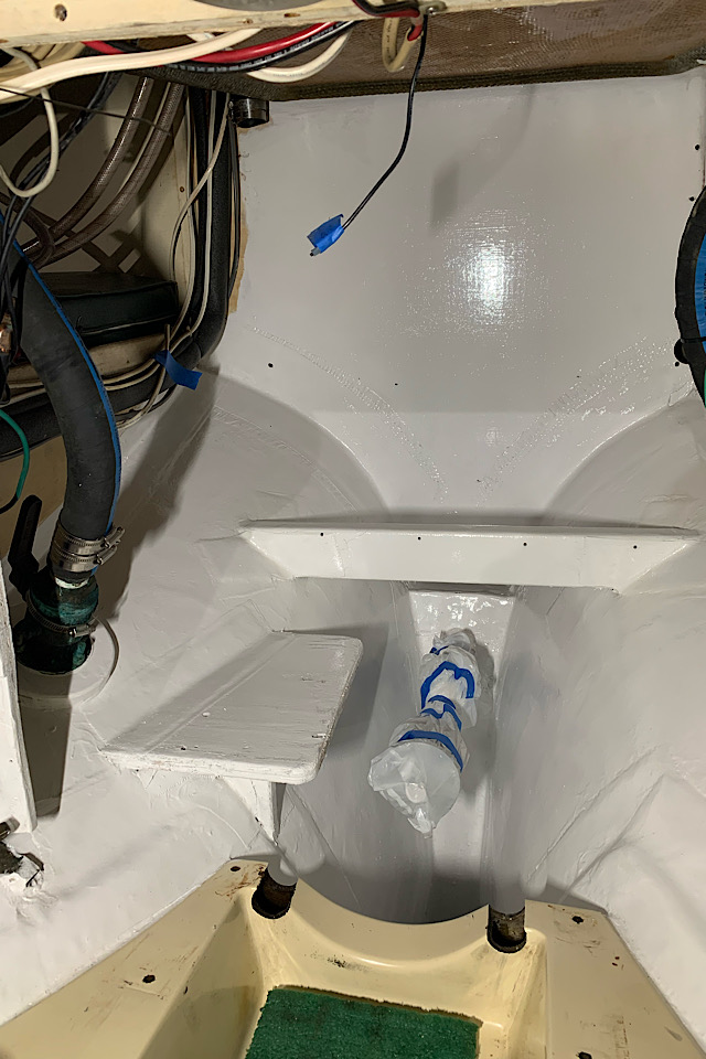

Hello Friends,
I know this thread is old and did not generate any discussion. However, I am planning to repower Little Wing with a new engine (Yanmar 3YM30AE). In preparing the engine compartment and bilge area, I wanted to know if my fellow BCC owners and past owners would be willing to share some photos of their engine compartments. I have a great opportunity to relocate the water strainers, battery charger, etc. after removing the engine. I am attaching some photos of the engine compartment with the old engine in it and the blank canvass where the engine will go.
Please share your thoughts and suggestions. Note: I am planning on adding the dual Racor 500 filters and that will fit nicely where the old water strainers were located on the starboard side of the compartment. Thanks in advance for your help.
Peter
More photos
