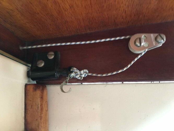

I’ve made a latch for the companionway hatch that can be opened from both inside and outside. Small take-apart hinges have a spring-loaded pin on one of the halves. That is screwed to the hatch’s aft cross piece, out-board so that the pin can go into a hole in the FG molding of the hatch surround. A small turning block mounted beside and inboard of the pin piece allows a small cord to pull the pin inboard (unlock). The unlock line goes through the turning block and out through a very small diameter hole in the hatch. I attached a small bit a leather to the end of the line to grab hold of. I used a bit of metal half circle to keep the pin pulled inboard for normal hatch use. A piece of wood could also be used for this.
I’ve never actually needed to use this latch. I’m cruising in BC and not on the internet or I would include some photos. Can do in Sep when we get back to Seattle.

Photo of my inside latch for the companionway. The hatch is locked. The line is pulled to unlock (from the outside). To keep it unlocked, (from the inside) the pin is pulled inboard and the keeper is inserted. The keeper is hanging from a short line.
