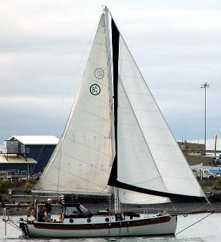

My rig seems to be slightly shorter than the standard BCC, probably no more than a foot and it is single spreader. I’ll attach a photo of my sails up and loose. the staysail stay also attaches a bit higher on the mast than standard. I wish I knew more about the history of the boat, all I know is she was previously named “Realm” and had been to New Zealand at some point. Maybe some oldtimers here have some knowledge of her past.
