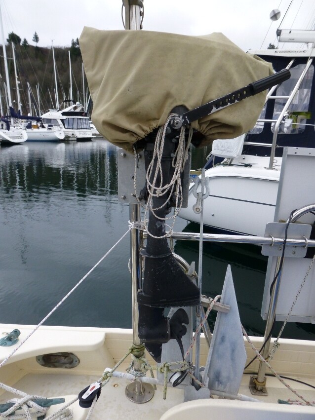

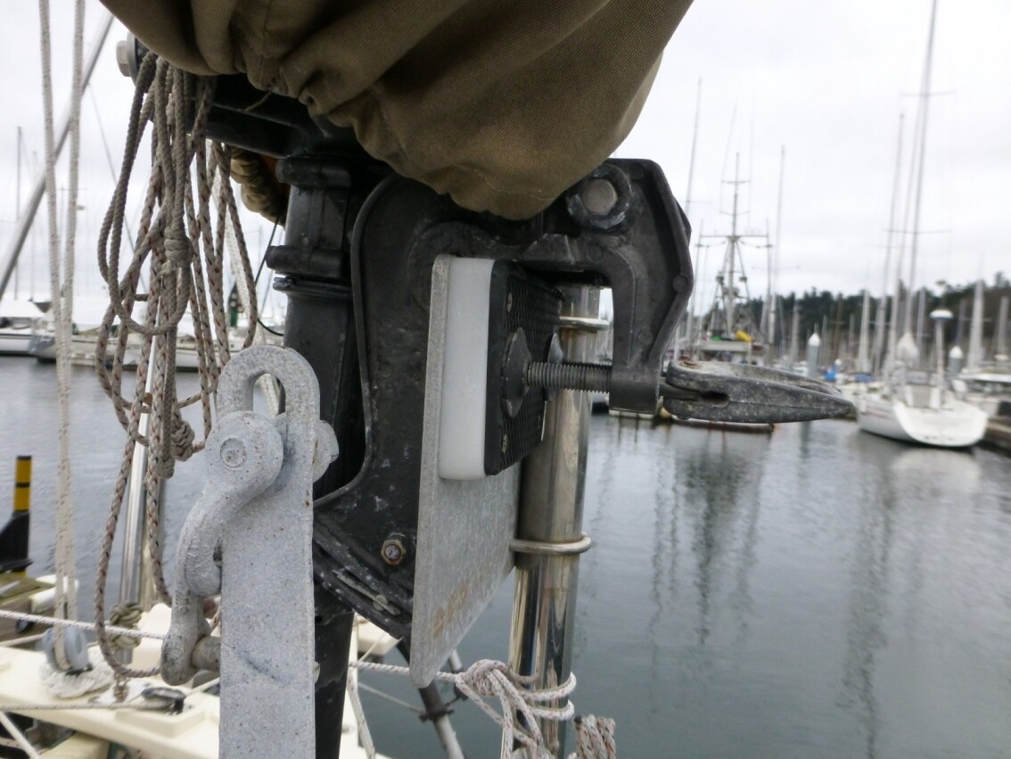

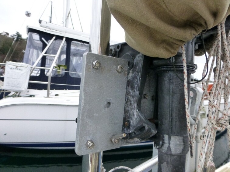

Your BCC is so gorgeous, as is Tom’s, I hesitate to show you my bracket. It has worked well, and is a mark II. (The first one (epoxied plywood) was really ugly.) For the mark II, I had a piece of 1/4" marine grade Al in Australia and was lucky to find U-bolts that exactly fit the boom gallows posts. I doubled the Al for the U-bolts–perhaps not necessary. I used some plastic board to build up the area that the OB clamps to. The 2.5HP Tohatsu fits best if the lower unit is turned about 180 degrees to the top unit and the whole turned parallel to the bracket. The OB doesn’t intrude too much on the cockpit seating. I try to sit there if we have 4 sitting in the cockpit. Everything on a small boat is a compromise, isn’t it??

Here is a photo
FWIW, My Honda 2HP fits real cozy on the inside of the boomkin. I knocked it together with stuff I could find here, a piece of starboard type material and a hunk of aluminum angle. This is the only photo I could find that shows it at all but you can see how it sits. Close, but no conflict with the rudder.

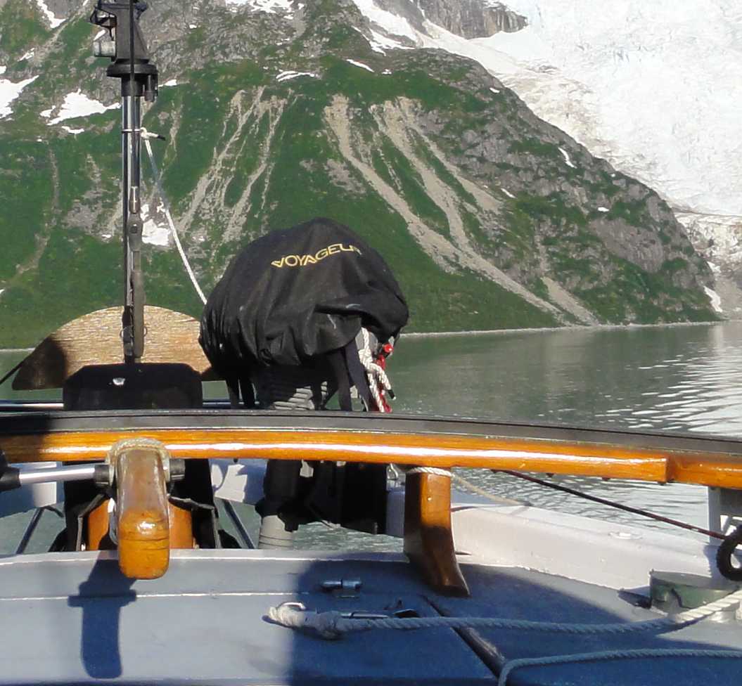

I put my Honda 2 on the gallows to be sure it was riding somewhere that it could not get into the water…lee shrouds or the boomkin in a following sea may expose it to possibly getting soaked (not a big deal) but also, being dislodged.

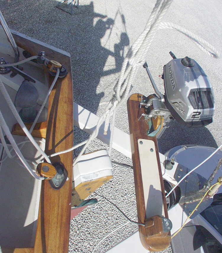

I’ve used the boom gallows frame for outboard brackets as well. Tharrer’s
points are on the money - the shorouds and boomkin are too exposed and
wet. I’ve stored a 2hp Yamaha and a 15hp Mariner/Mercury on my brackets
and never had a problem. With the 15hp engine, I use the boom with 4:1
tackle as a davit to lift it to/from the dink.

here are some close ups of my OB bracket
here are some photos
here are some photos of my OB mount as promised…the stainless steel plate is 4"X8"…welded to a split piece of SS pipe 8" long with an OD of 1 1/2"…the pad is teak 6W X 5H X 2 thick…it is in two pieces, routed to the thickness of the SS plate (which someone forgot to measure??) and then through bolted. We built the u-bolt clamping pieces out of slightly smaller SS pipe pieces.
