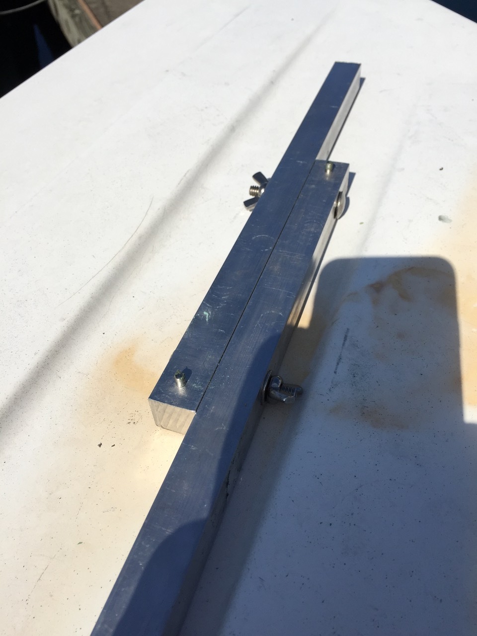

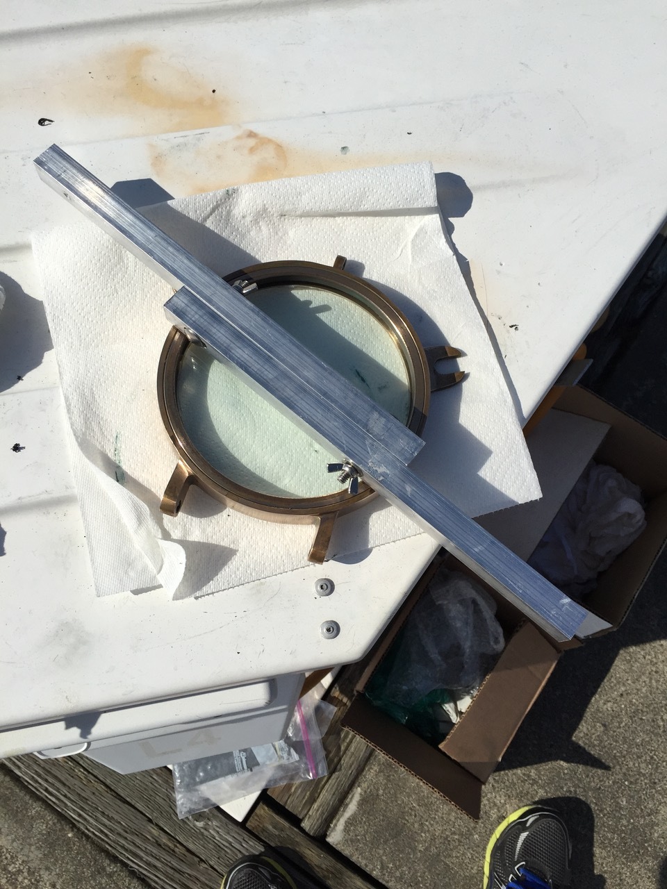

The tool … after extensive searching for a large (I think that it was 8-in) spanner, I fabricated one from aluminum bar stock and pressed in the right-size (can’t remember the dimension) stainless dowel pins, with some temporary Loctite to hold them in place. I also drilled out a channel to adjust the size of the spanner, locking it in place with a pair of carriage bolts and wing nuts. This tool worked great for me, and I belive that this spanner is the secret to an easy glass replacement. I did six portlights in one afternoon.

I uploaded some pics from my glass project, and there are some of the tool in there. Probably ended up with 5 duplicates, but I’ll weed them out.
I think that BCC portlights are bigger than those for FC. I can drill out some new channels to accommodate the larger size, but let me know what the distance is between the tiny slots for the spanner pins.

FYI, attached are a couple of pics of this tool.

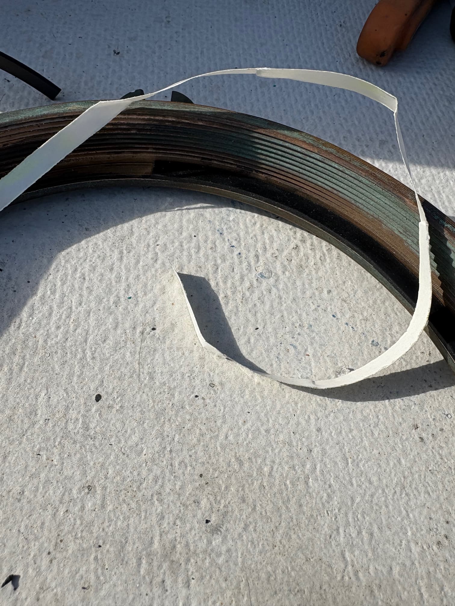

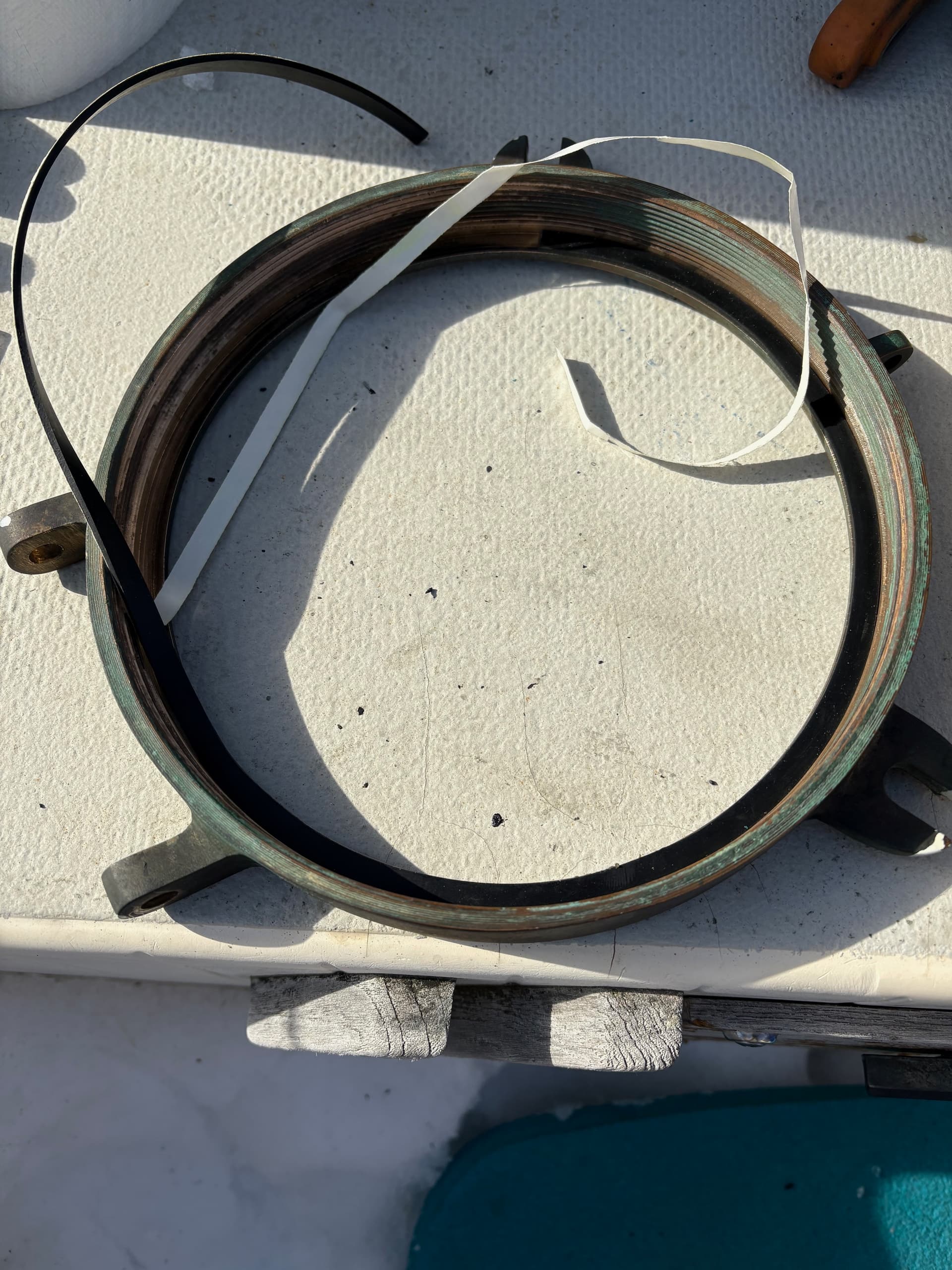

  2. I also dedicated way too much research and some trial and error experiments to figuring out what to use to seal between the “glass” and the portlight frame. I was planning to use Dow 795, which appears to be the standard adhesive/sealant used when people replace their acrylic boat windows. However, I wanted to be sure to get an even depth of sealant, and wasn’t quite sure how to do that without spacers. Given the very small area to work with, I was concerned spacers would leave too little room for the sealant itself. Additionally, it seemed that it would be challenging to get everything masked off properly to ensure a nice neat final product. Therefore, I decided to try several different types of rubber as a gasket. In the end, I found 1/4 inch wide 1/16 inch thick EPDM to be a great fit (McMaster Carr #8525T158). The adhesive backing was helpful as I positioned the gasket on the portlight housing before putting the Lexan in place (see attached photos). Significant testing with a garden hose directly at them illustrated no leaks.
