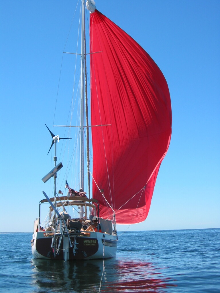

HI Rod, When we had the big symmetrical the wind was usually well aft and the chafe was less of a problem. With the asym, we tended to sail closer to the wind to raise the apparent and gain ground speed. this led to a need to use Spectra for the tack pendant, allowing a higher tack and avoiding chafe.
I know the pic doesn’t exactly show much detail but I couldn’t help it, I like the pic. Cheers to all, Ray
Ray:
Thanks for the photo. From the photo it is apparent chafe is not a problem. I like the solution because one does not have to go out on the widowmaker.
Although there is very little wind, based on the slick in the photo, I imagine the boat was making perhaps 1/2 kt. That’s better than zero knots.
Nice shot of the WHISPER under spinnaker.
Hi Ray,
Ditto on the thanks for the pic. Great shot. I will be rigging mine similarly, when the time comes. I also like the tower you’ve erected for the solar panel and wind generator. Very simple. The PO of my boat had a full-on radar arch mounted that sort of ruined the lines of the BCC. I quickly took it down and am looking at options.
