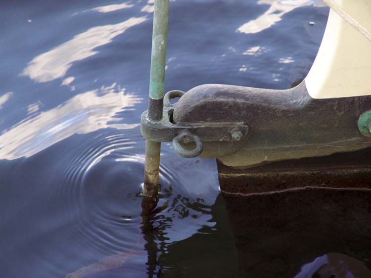

Bronze Eye bolt for rudder stop lines - BCC AURA, Baltimore, MD
Check with www.RWRope.com for bronze eye bolts - Davey and Company, Ltd catalog.
Thanks Rod, great pic. I’m trying ti install that style windvane, so would be ideal.
