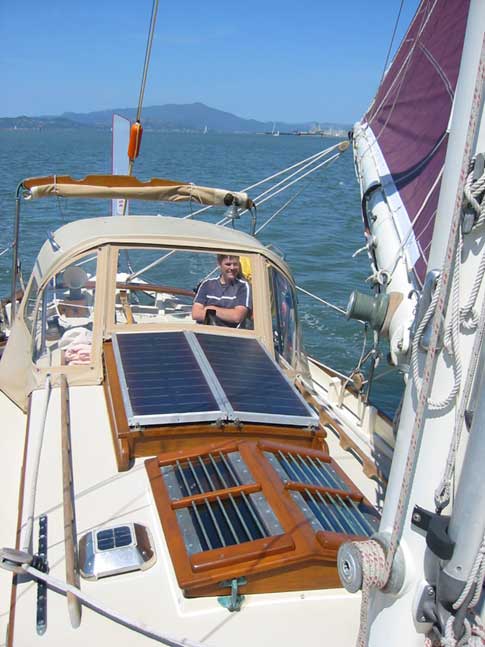

We had the same experience when anchored for more than a couple of days in the Channel Islands. Just using the cabin lights, radio etc drained a battery if the engine wasn’t run. We istalled the two solar panels on top of the turtle hatch (Pic attached) and that has worked great. While we don’t have refrigeration, these two panels gave us more than ample charging power without ever running the engine while at anchor for extended days in Mexico. I originally installed them so that they could tilt up in the early or later part of the day, but have found that this is not at all necessary. They are also the type of panel that will work with rigging or boom shadows.
