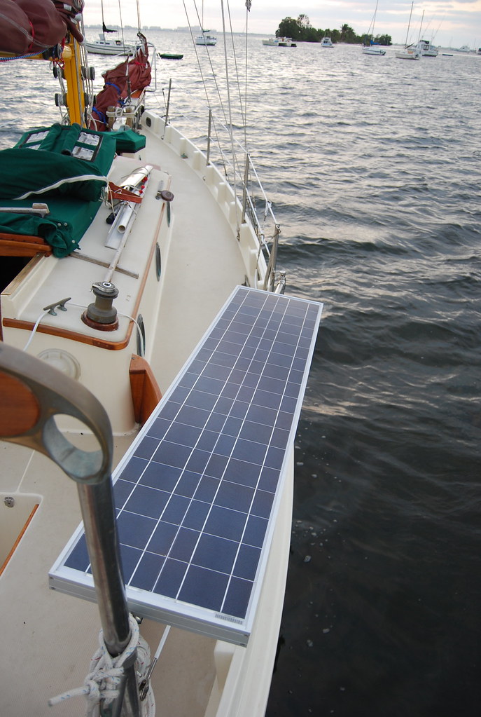

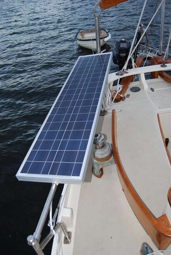

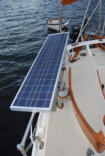

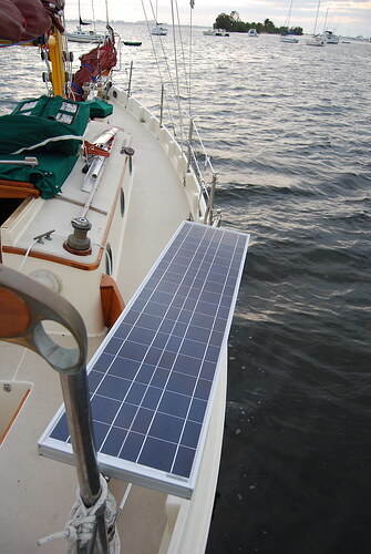

Just wanted to point out a decent solution for mounting a solar panel on the BCC. I found this 65 watt skinny panel that is 13" wide. It fits pretty nicely on the rail just forward of the gallows. I replaced the lifeline with a 1" SS tube.
It’s not in the way of the main sheet or the jib winch, and doesn’t obstruct the side deck or climbing aboard from dinghy much either.
I’m pretty happy with the one I bought, and am looking to replace my wider 80 watt panel with another skinny panel, so both sides will be “skinny”.
In these pics, I could have moved the panel outboard slightly, and I will most likely do so at some point to make a little more room at side deck/cockpit entrance. One other note - I don’t have a dodger, so I do have more space right there. With dodger, I’d say you’d need to put edge of panel right above the SS tube, and add a support leg.

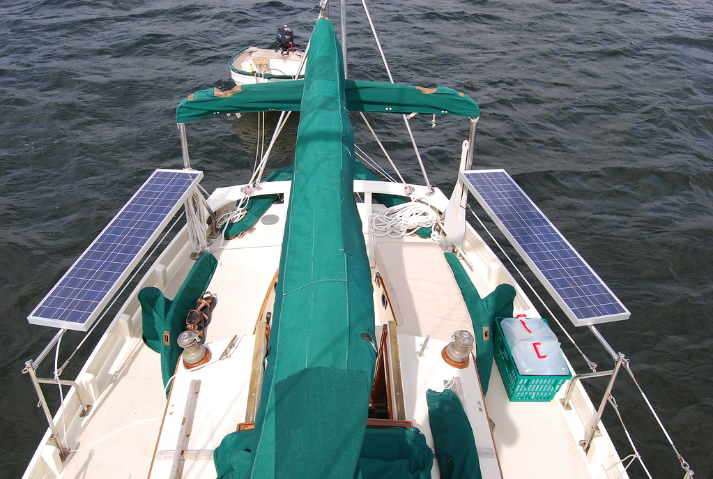

Updated pic with my 2nd skinny panel added…130 watts total.
