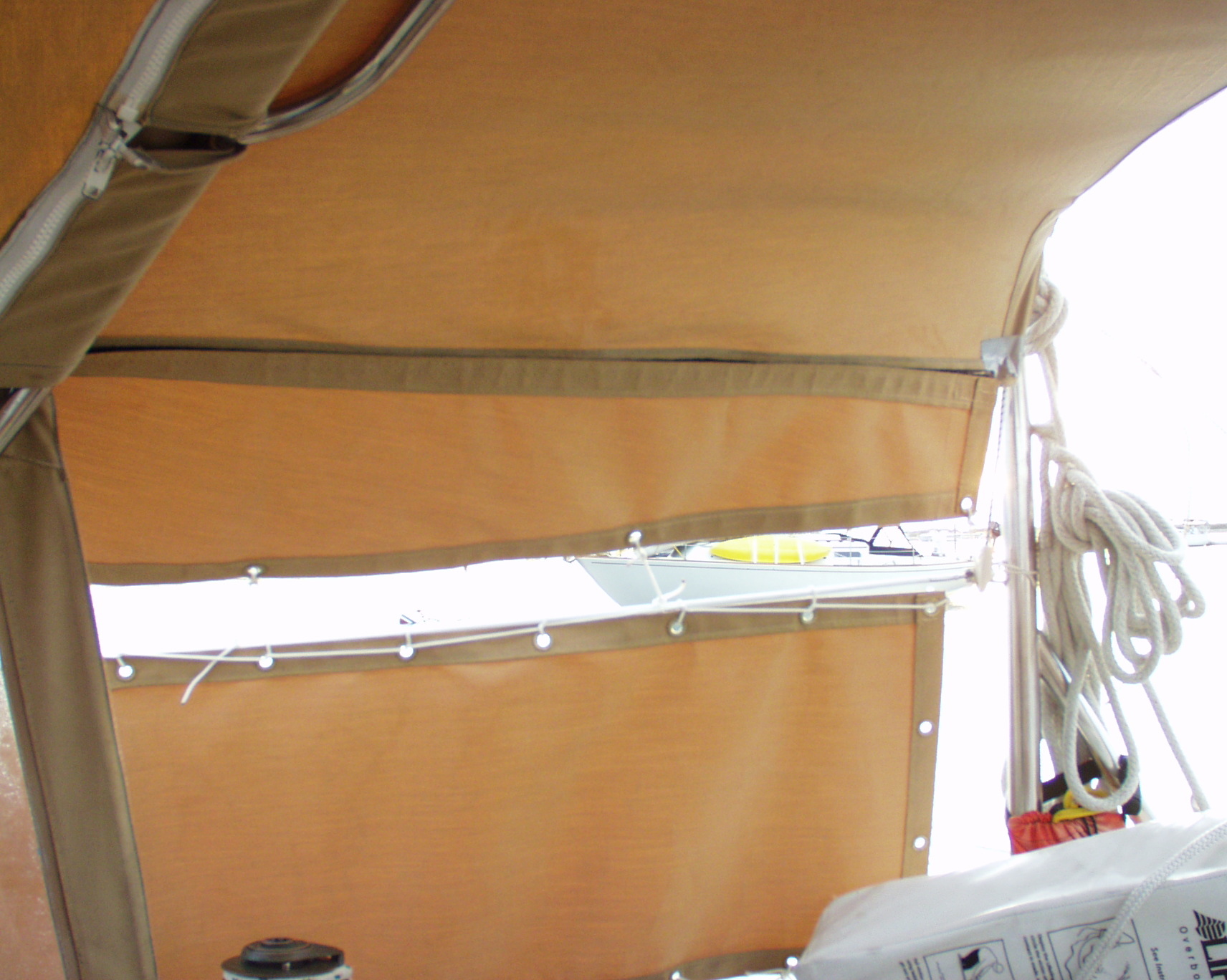

Hi Mark, some comments below:
Mark Giegel Wrote:
Hey Scott , How are you guys?
Hi Mark, yes we are settling into a nice old house in Belfast. Just a short row out to Itchen, moored at the head of the harbor just off the very efficient and accomodating Belfast Boatyard. I took her out for a sail yesterday morning and it was so lovely – nice breeze, still a lot of Fall colors on the trees, sunny and crisp – so I called Dot on the cellphone, she walked down to the town landing and I picked her up. We may get one more sail in next week before we haul for the winter.
If I could get some pics of the top, sides and
open area up forward that would be great. I had
the hood made by Mike Anderson and I should have
taken pics when it was delivered. To remove there
are plugged fastener holes along both sides near
to the deck that have to be removed. Once removed,
you can back out the screws which are fastened
into a wood cleats on both sides which are in turn
fastened to the deck.
Attached are three pics of the companionway hood. I meant to take more this morning when we went down to remove the roller furling yankee and heavy up the chafing gear in prep’n for TS Noel. Chris Parker’s forecast this AM was an unwelcome wakeup call, with Noel heading rather more westerly than expected.
It was too cold for the camera & batteries and it went on strike after three shots but will take more next week when we haul if you need want more detail.

I was looking for a companionway cover. I had one made by Mike Anderson for my previous BCC. I am just looking for the basic dimensions so I can build one for my current BCC. I did contact Scott who curently owns my first BCC and he is sending pics to me to refresh my memmory. That should be sufficient to build the spray hood. Thanks.
Sincerely yours,
Mark
SV “Lightfoot”
Hello Scott and Dottie,
Scott,
Thanks for the pictures. They are the detail that I needed. I don’t need any other pictures at this time. Hope you made out ok with TS Noel. Good luck with the digs in Belfast.
