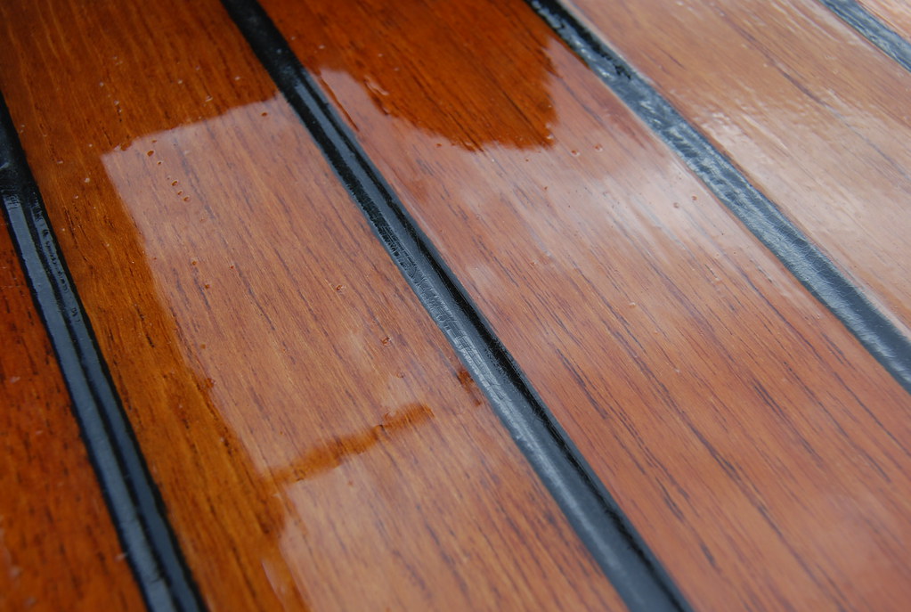

What I’ve found is that the caulk used plays a significant role in how the varnish will hold up, or how it will look I should say. I can say that Boat Life Type P 2 part caulk does not work as well as their one part caulk. Type P shrinks in the seam leaving a hollow between the ‘planks’. It also causes tiny hairline cracks to develop. I’m not sure if the cracks are in the caulk or in the varnish.
I’ve had better luck stabilizing the cracking by using Bristol Finish, the 2 part ‘varnish’. But time will tell, It’s been a few years, but most of my hatches rarely see the light of day. Initially I laid 8 coats of Epifanes rapid clear, then 2 coats of regular high gloss varnish. The cracks showed up as white cracks everywhere after a few months. I just added 2 coats of Bristol Finish to the hatch this spring, and the cracks have been muted. 2 pics are linked below, I just took these. Excuse the dirt in the varnish, it was a windy day, in a dusty marina :frowning: But I’ve always been one for ‘protection over perfection’.
Although I like protecting the teak, one thing you lose by varnishing the tops of the slide, turtle and scuttle is the natural non-skid characteristics. But this has never been an issue that made me want to strip my hatches.
So, if I were to do it again, I’d use Boat Life single part caulk (or some other brand), and go with my regular routine of Rapid Clear for build coats, and Bristol Finish for top coats.

I think CPES is a good product. I used it on my bulwarks before painting. 2.5 years into the painted bulwarks, and no major cracking/splitting yet… still too early to tell though. I do have a crack at one seam. I only did one coat of CPES, would have liked to have done two, but ran out.
One part boatlife seems OK. I do notice a bit of a greenish/brownish tint, but it doesn’t bother me. That might be because I used ALL Bristol Finish (6 coats) on that hatch, which has pigment in it, and that would tint the caulk a bit. The Type P seems to be more true black, but that could be because I used Rapid Clear to build coats.
I tried to run good experiments, but there are so many variables.
I did just take pics of the fwd scuttle hatch, with uses Boatlife 1 part, and now I’m noticing a slight, very slight hollow in the caulk. But you can see, no cracking, but slight brownish tint from what I can say with 95% assurance is due to Bristol Finish.
