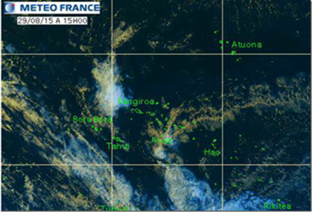

Can I also note (as Kendal likely knows) that this later half of the year is a usual time for cruising west from Tahiti to Fiji, Tonga and so on.
One of the gurus for weather condition as they affect cruisers in the S Pacific is Bob McDavitt, a retired meteorologist from New Zealand.
For many years, Bob was the NZ meteorologist who liaised with cruisers.
In retirement, Bob runs a weblog on weather in the S Pac.
In today’s (12 July 2015) weblog entry, Bob discusses conditions for cruising routes west from French Polynesia, among other possible routes (and of course a discussion of the weekly state of the ocean/atmosphere coupling).
Bob McD usually updates his blog on Sunday (NZ time). He updates more frequently when weather conditions warrant, such as when tropical storms (called cyclones in the western bit of the S Pac) loom. See Bob’s entry for today at:

Note Bob McDavitt’s web log entry of 30 August 2015, discussing three routes West from Tahiti in the context of the current El Niño conditions:
