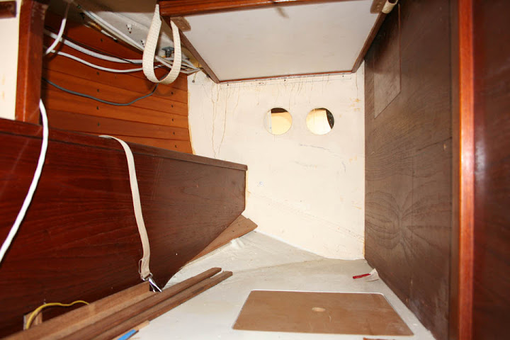

Well there’s the cowl vent option like I have on Elizabeth, through the deck which vent into the head compartment and the lazarette. I have 4 4" holes in the bulkhead forward of the laz to help facilitate ventilation to the engine room and main cabin via the 1/4 berth.

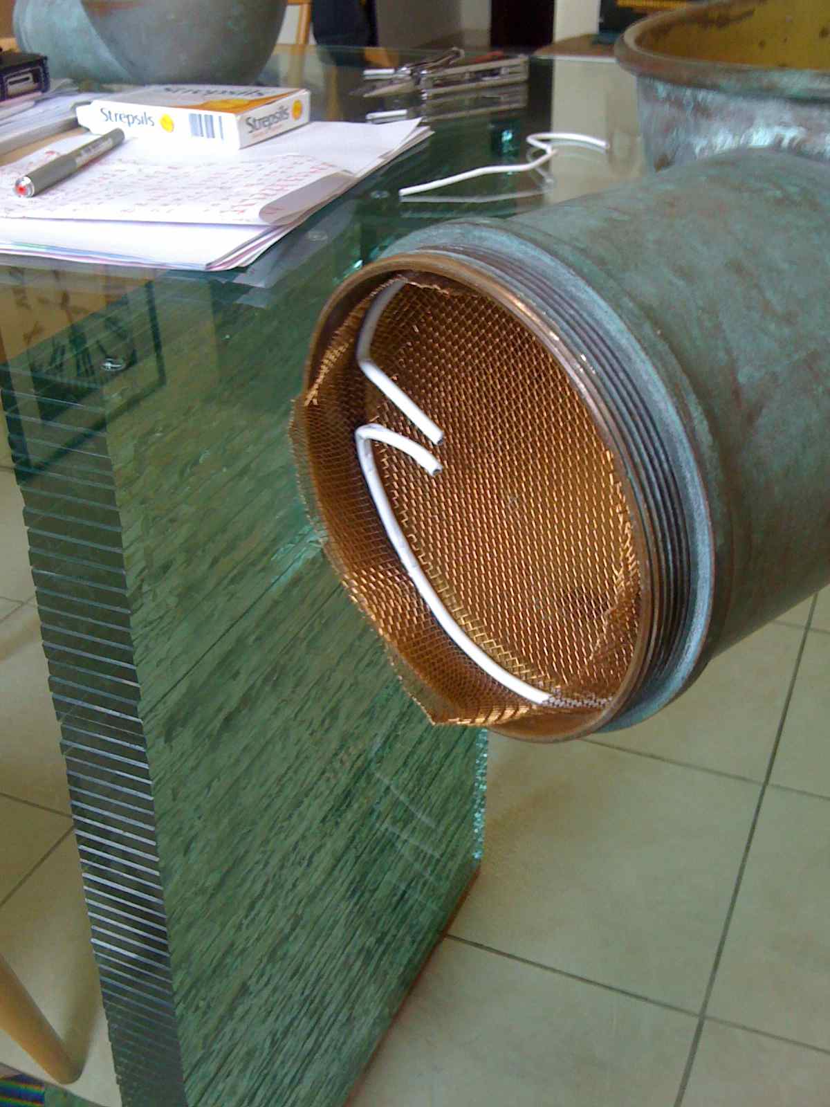

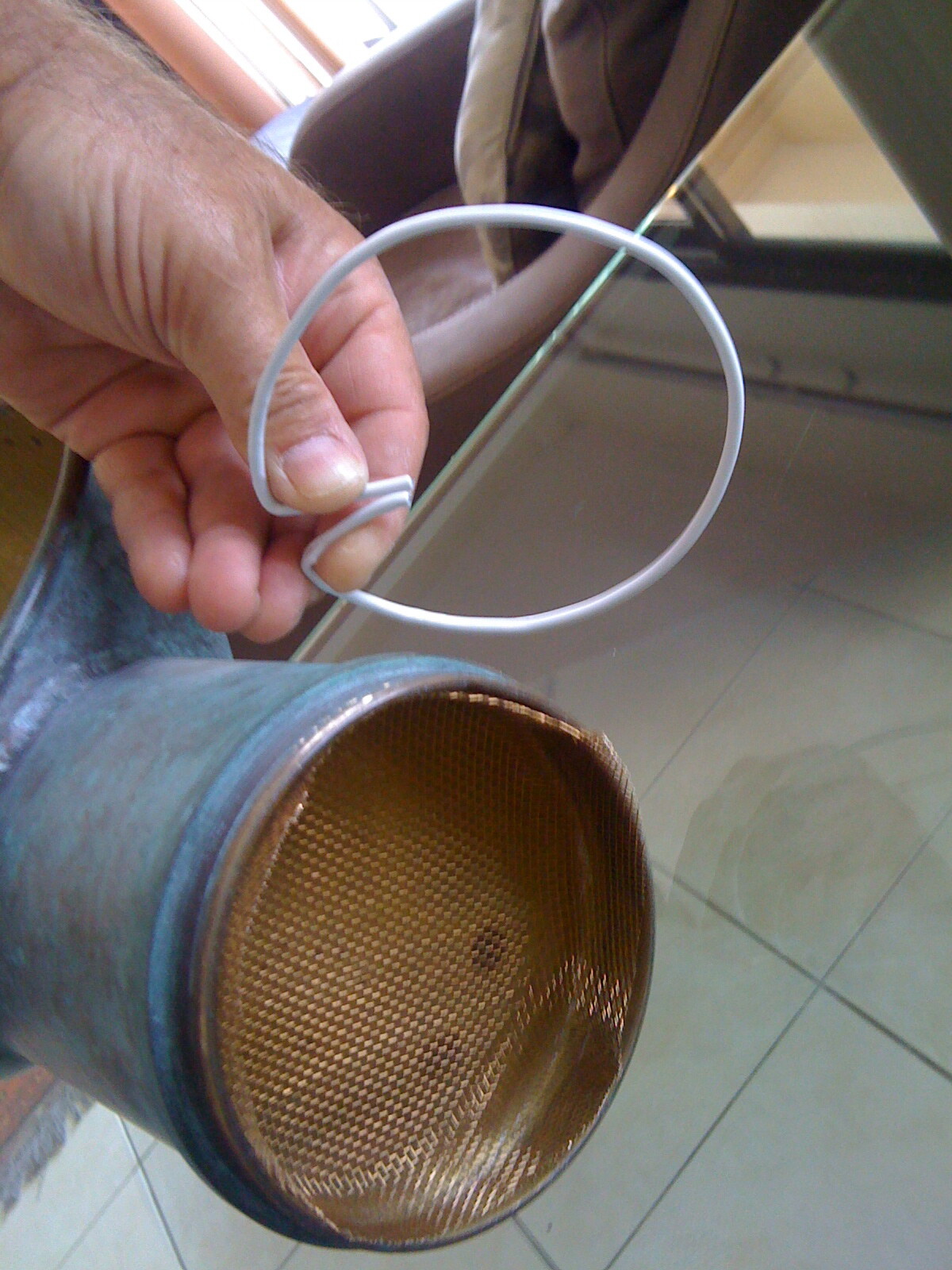

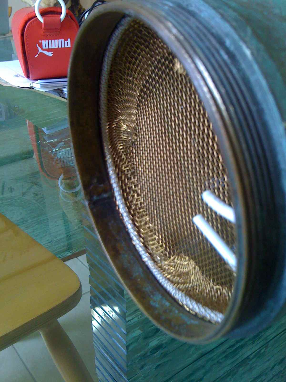

As the weather is seriously heating up, I decided for the first time to fit the dorades to get some air movement through the boat while she’s unattended during the week.
I have one centre foredeck, and the other aft starboard, ventilating the quarter berth.
Once I’d screwed them in, it occurred to me that they were ideal entry points for mosquitoes, cockroaches, and the adventurous rodent…
I found some bronze mesh, and cut it into a circle bigger than the throat of the dorade, then folded it into a dome and forced it up from the bottom of the dorade.
Taking some sturdy plastic covered wire from a coat hanger, I bent it into a circle bigger than the dorade tube, and with a right angle bend at each end.
Forcing these bends together constricted the wire ring, making it small enough to fit inside the tube, and the mesh.
Releasing the two bends allowed the springy wire ring to push the mesh outwards, and into the recess at the throat of the dorade.
The outer excess mesh was bent inwards around the wire.
It’s made a practical barrier for all but the most determined of intruders, and isn’t easy to dislodge.

For some reason I was only able to attach one photo the the last posting.
Here are the other two !
Good idea and nicely done.

where did you get the bronze mesh? Any other good ideas for screening the hatches, there must a simple way…
The mesh actually came from the States! We are using it for some decorative flyscreens on 100 villas in Abu Dhabi.
I’ll try to get the address of the manufacturer for you later - it’s easy to cut and form.
The whole job of the two Dorades took maximum 35 minutes - I can’t make it simpler than that!
