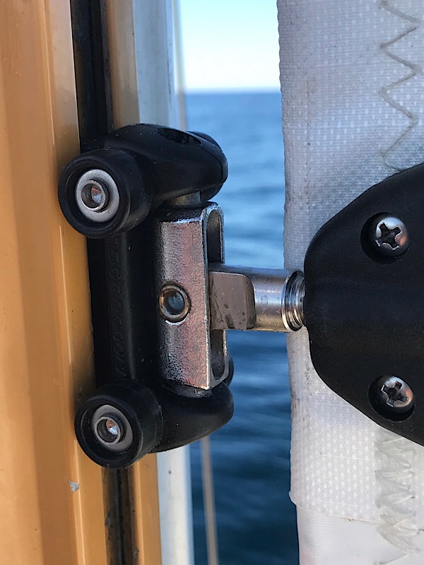

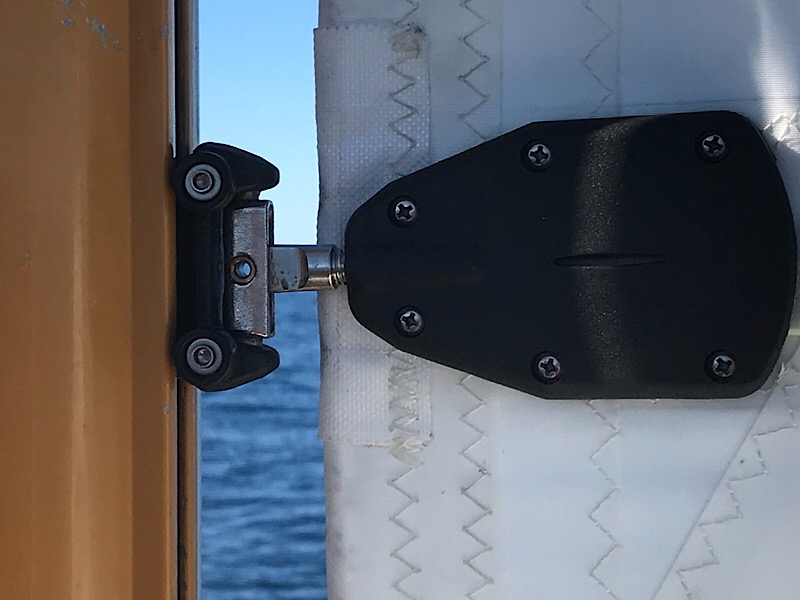

I tried to get away using my old batten slides on the new sail. This was a spectacular failure. I considered a Strong track but it was all complicated whilst travelling so on the advice of my sailmaker I replaced them with Rutgerson batt cars. The main comes down so fast it’s almost scary and I have been able to reef in most conditions without too much trouble. I may still consider the Strong track in the future but it’s no longer a priority.

Any pictures of these rutgerson batt cars and costs and how best fitted. I assume they clip into the existing track in the mast. I am envious of the guys who sail up to the anchorage and then main falls down. I have to talk to mine sometimes and occasionally the mood can be a question. Anyway she comes down but a quicker descent would be nice.

Attached will hopefully be a couple of pics of the Rutgerson batt cars. I paid Au$77 each. There are 5 of them on the sail. They screwed straight into the batten pocket thingo.
I’m sure the Strong track would be better but these are working very well for me
